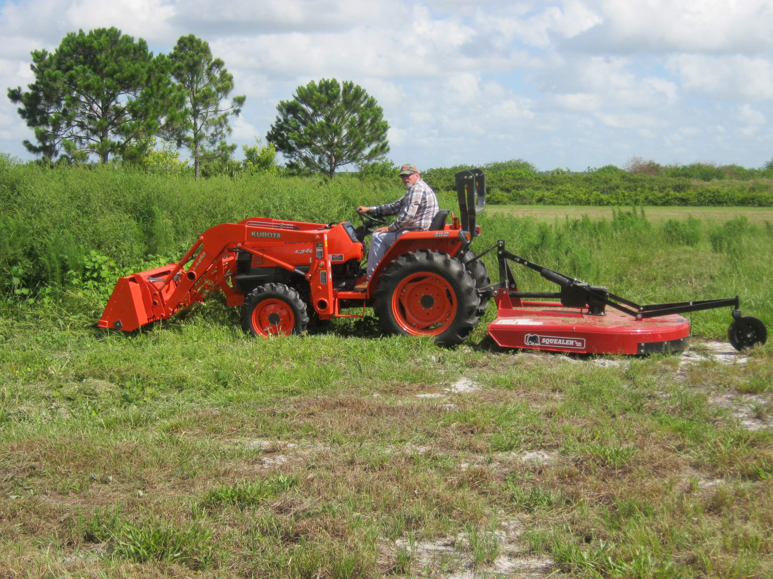

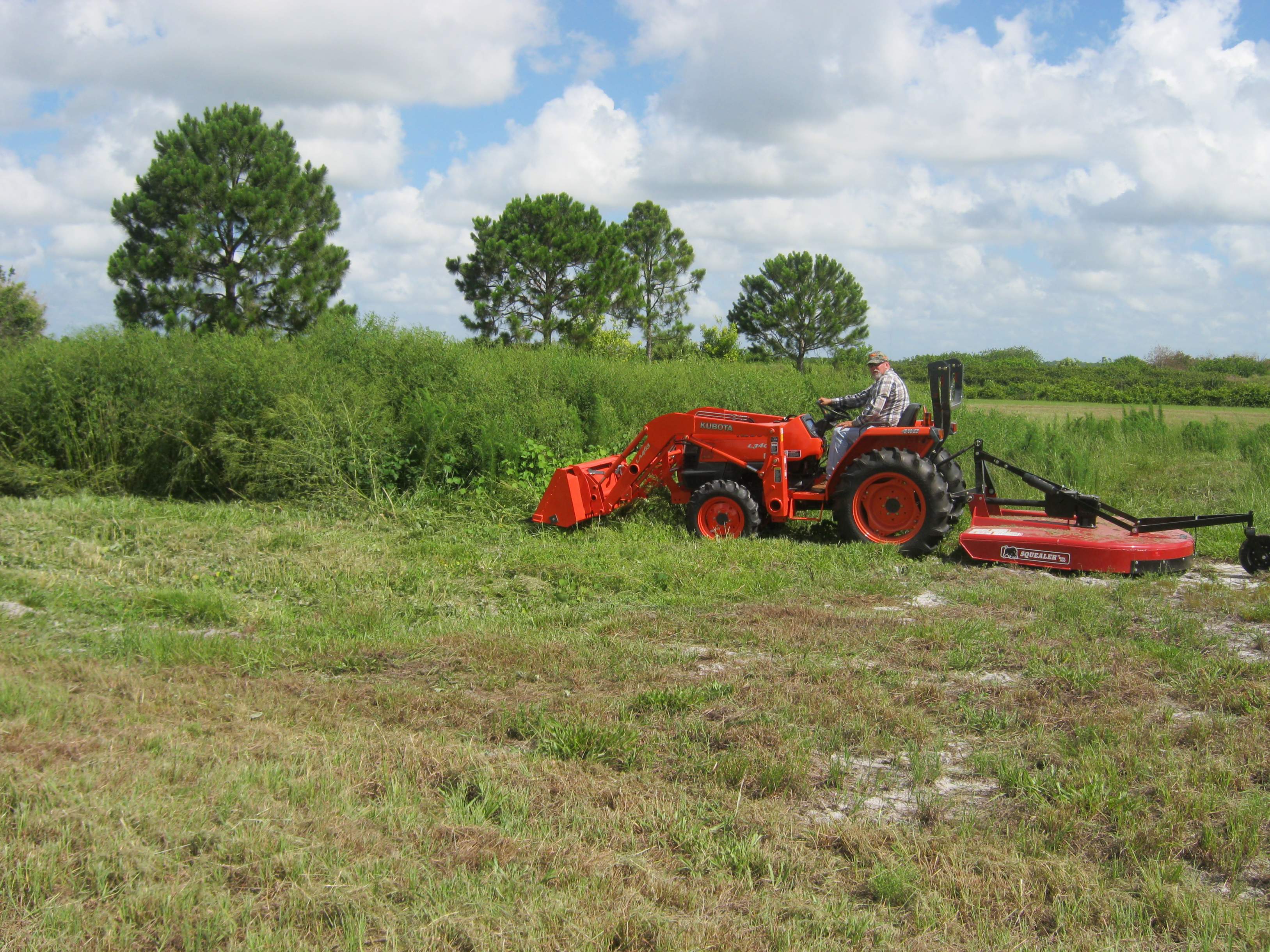

I also would stay with 5' bush hog.Espeicially since you state you only go there once a year.Remember a properly maintained(sharp blades, etc) 5' -ter will work better than any 6'-ter not keeped up.
I run a 6'(sq172) behind my L3400 Bota with no problem but the places I maintain I visit "frequently".The first time I bush hogged these places it was a bear(slow golng).
