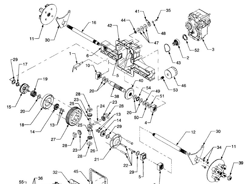

I have a CC 3225 Garden Tractor with Hydro transmission. I noticed a slow leak in the rear of the tractor and after cleaning it up appears to be coming from the Hydro rear cover. The cover looks to have about 15 or so bolts holing it in (maybe 3/8") Anyone else ever have a leak from the cover gasket here? I tried tightning up the bolts but they were all snug. Anyone ever pull this cover? Is there a site online I can look up the part number from a diagram for the gasket?

If the leak is coming from the left of the gasket (there are 2 of them) then the gaskets are not the problem. The hydro oil is leaking into that chamber from what I think are called 'pillow block bearings', which are no's 10, 5 or 6 in the drawing. It is difficult to tell from the drawing which it is. What year is your tractor? Anyhow, to replace them is somewhat of a major task which will require replacing both gaskets, pulling out the shafts etc. I know this because I had the same problem. Is your transaxle casing aluminum?

Year is 1998. Is it difficult to get that suspected bearing out? Is it pressed in or will I be able to tap it out? I assume I need to disassemble some stuff. Is it very involved? I assume it is bearing #5 in the attatched pic that is the problem. I have oil leaking out the left side of the axle from that bearing.

Yes it is that bearing #5. If your gaskets were leaking then you would find the oil dripping from the bottom of the transaxle casing, not the left side that you describe. The hydro fluid is finding its way into that left cavity and leaking from there. I suspect the bearing is the culprit, not the gasket.
When it happened to me ( I have a 1999 3205, almost same model as yours, with an aluminum transaxle casing ) I thought it was the gasket(s) as well. I replaced them and the leak came back. Finally my neighbor, who is a mechanic, helped me figure out the true cause and replaced the bearing. It wasn't something I could have done on my own. The bearing is not pressed in but, as I recall, some kind of silicone sealant is used to seat it. In order to get at the bearing, or replace the gaskets, you have to:

Ok, thanx for the info so far. I have everything off and the differential casing cover off. Now, I am a little confused as to how to get the left axle and bearings out. Do you have to remove the for bolts (#22) and then the retaining clips and then slide shaft with hub assembly attatched out to the left? Or did you remove 7/8"nut on hub, remove hub, remove brake mounting bracket # 30, and then left axle comes out?
