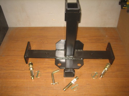

I have not seen a 5th wheel hitch for the 3-pt trailer movers. However, they do make gooseneck to 5th wheel hitch adapters. You can try that and see if it'll work on your trailer mover. If I remember correctly, Reese or Husky makes them. I was considering the same issue awhile back, but never really followed through with it.
Hawk
   / 3pt hitch - 5th wheel/gooseneck #3

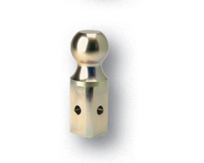

B&W makes an 5th wheel adapter that fits in their gooseneck hitch. If you had a tube at the top of the 3pt attachment you could put either in to move trailers.

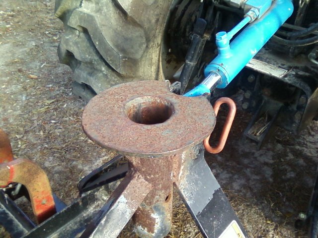

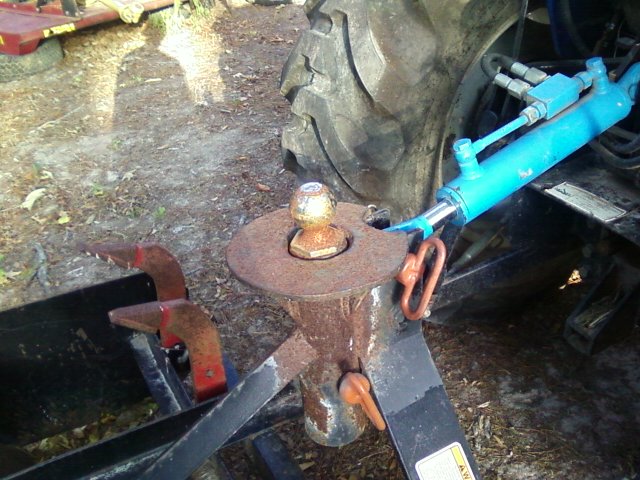

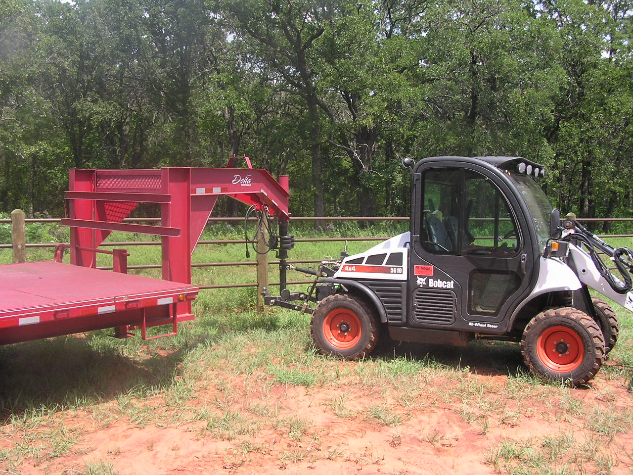

Sorry I don't have any pics to post.
I built my own on the box blade just behind the top link connection.
It consist of a piece of pipe (sleave) with an ID the same size (a hair bigger actually) as the pin on the 5th wheel. It has a flat plate or collar around the top of it for the pin box to rest on. Then I have a pipe with a 2 3/8 ball welded to the top of it that I can slide into and pin in the sleave.
I hope this makes sense. I try to get some pic's and post back this evening.

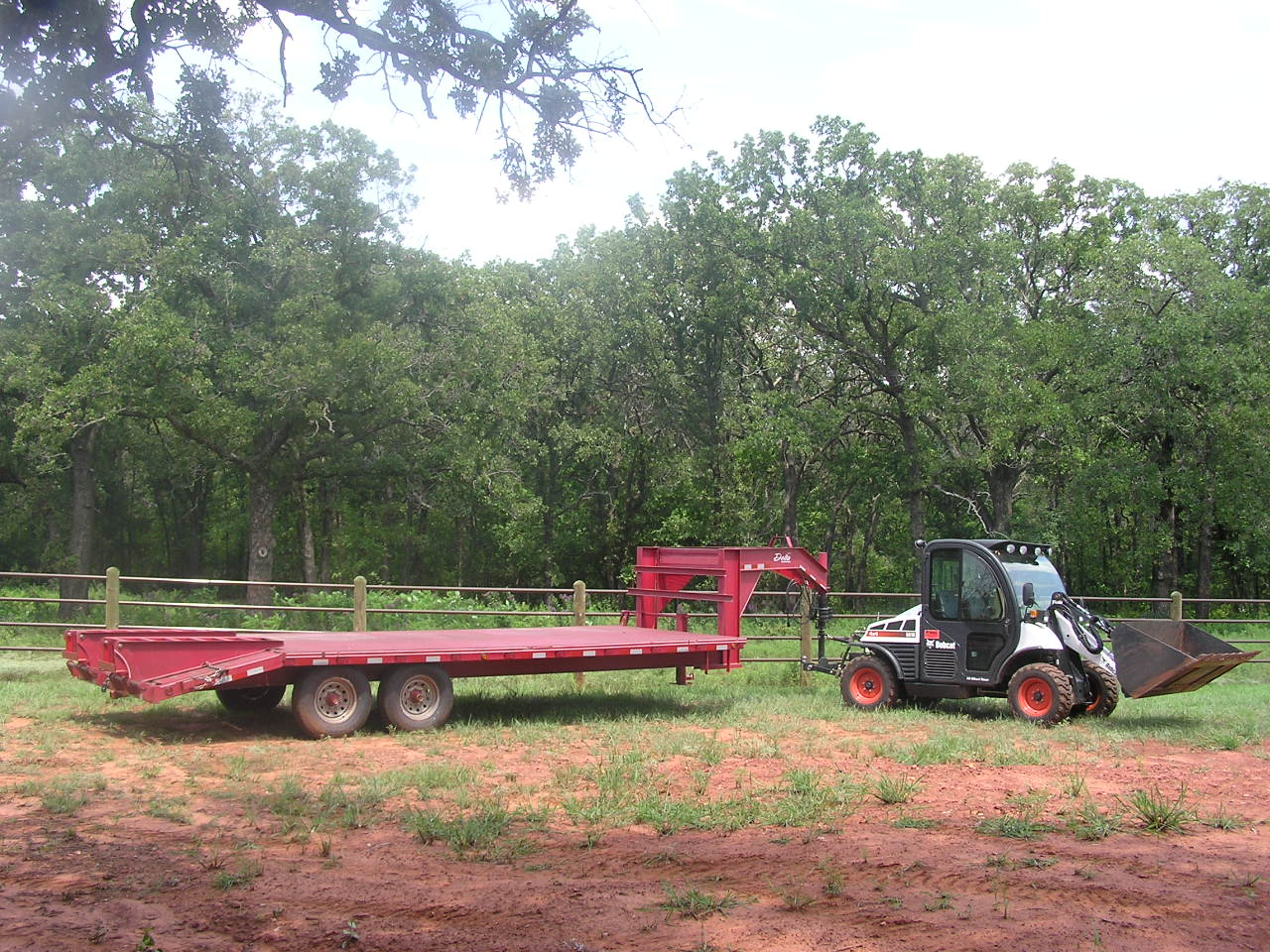

Here is the box blade with the mods to move a 5th wheel and gooseneck.

Neat idea Firedog. Next time I get to welding on the box blade.. I'd like to do something like that.
-Luke

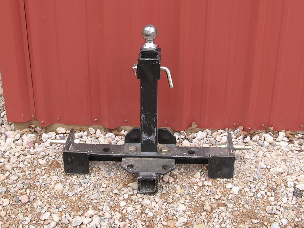

I welded a 2 5/16ths" hitch ball to the top of my trailer mover hitch. That works for goose neck as that's mostly what I move. For 5th wheel I just slip a piece of pipe over the ball. Works for me. If some one want's pictures I can post them.

Thanks for all the details. My RV has a 5th wheel king pin, not a gooseneck. What appeals to me about firedog's approach is that I can utilize my boxblade by simply welding on a cylindrical metal sleeve and a flat disc. Gotta say, that "tractor" of yours in the photos looks neat.
