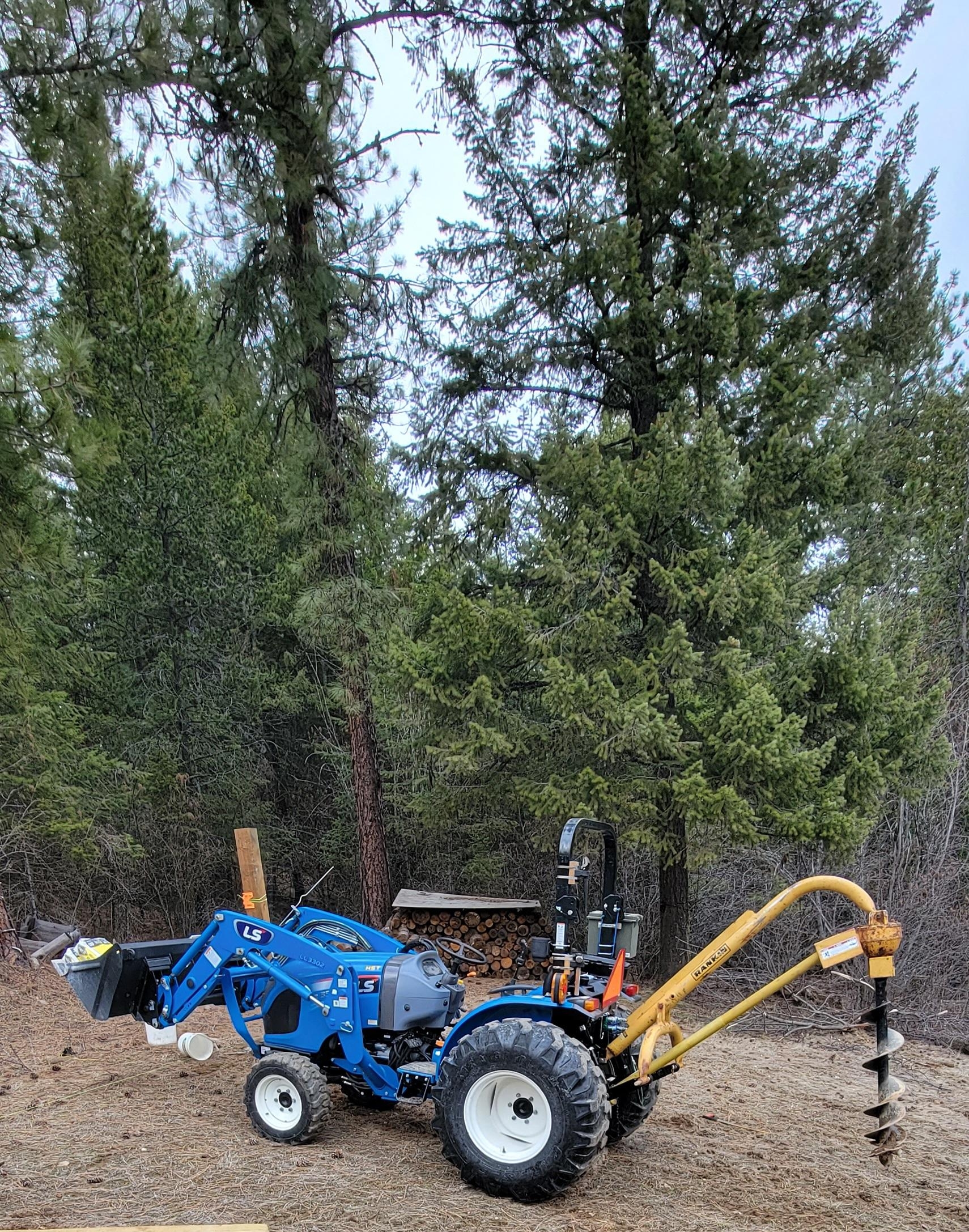

So I dont have a tractor right now but one may be in the near future. At this time I am looking at some used Groundhog HD99 towable post diggers and Stihl BT131 one man post digger. Anyone have any advice on one or the other. Most of my jobs will not be too intense with just a couple of poles occassionally.

For only a couple holes once in a while, I would do them by hand or a one man auger. With gravel, it will be a job with an auger though. Hooking up a 3pt auger can also be a chore if you are alone and don't have a hanger or stand to hold it in position.
   / 3pt post hole digger vs one man auger vs Groundhog Digger #7
I had a nice powered auger, but sold it because I thought I was going to get hurt because of all the rocks in our soil. Even with a PHD on the tractor, I have sheared multiple bolts digging post holes.
