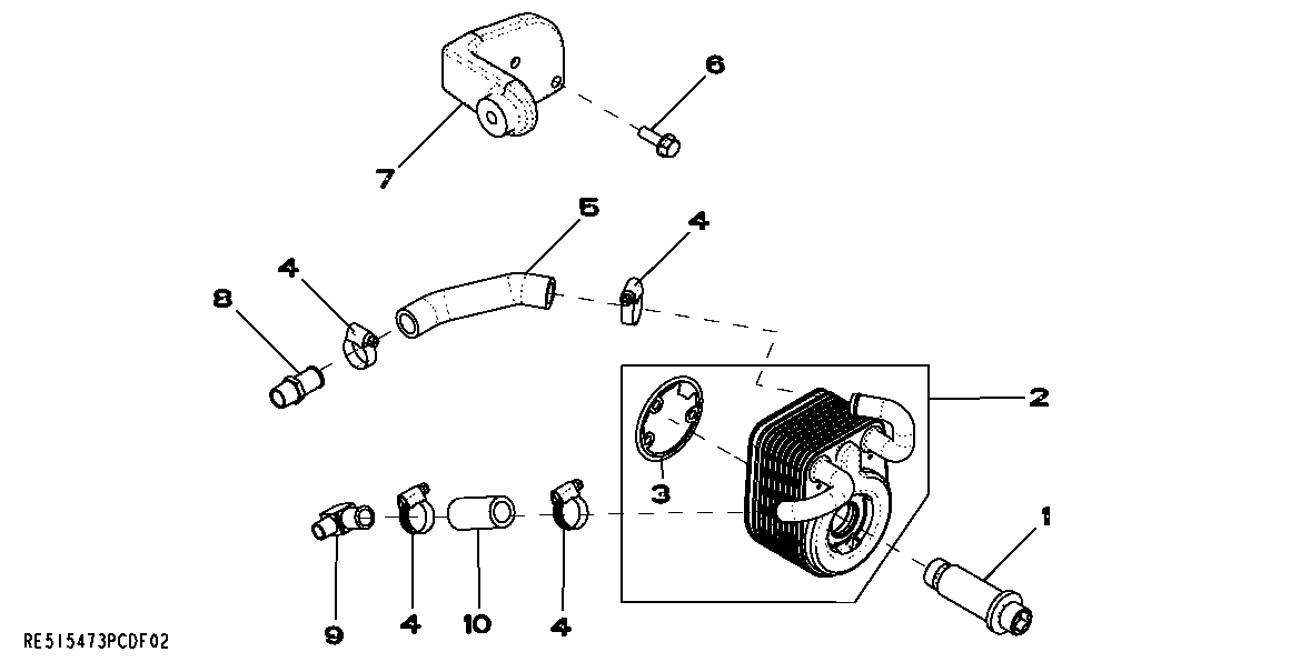

Radiator filed with oily sludge and expelled all the coolant after blowing the cap of the overflow reservoir. 1500+ hours. Any ideas? Head gasket? No sign of any coolant in the engine oil.

If there is oil in the Radiator then there's coolant in the oil.
   / 4120 R.I.P. she died today #7
The oil in the radiator could be the engine oil cooler. We've seen a few of these fail. The coolant blowing out sounds like a head gasket or cracked head. Did it overheat?

Oil cooler would make sense because the oil pressure would push out into the radiator and that explains why I don't see any coolant in the oil. May need other repairs now due to running without coolant.
Any easy way to test the oil cooler?
   / 4120 R.I.P. she died today #10
I would remove the cooler and plug one end of the water pipe and pressure up the other port if it leaks into the oil cavity it is bad.. Since it is easy to get to the cooler (behind the oil filter) and the oil is under pressure there I think it is a good chance the cooler is the culprit. Besides you have to start somewhere.
