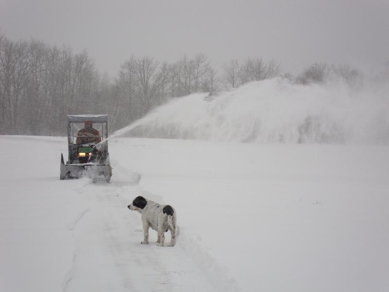

Hey there,
I don't have a blade but I noticed a big traction difference on my rig when I went to the 26in tire that the 445 and 455 use. I went with a knobby looking tire filled with windshield wiper fluid and 70lb cast iron wheel weights. Pryor to that I had 23in weighted bar tires.
I have a 3 point I could have hung more weight off however I haven't had to with my new set up.
The pic is from our last sizeable snow. My first pass was plenty goofy because I couldn't really see my road. So instead of my normal 2 passes I ended up maken 3. Not sure what my Springer is looken at but if I had to guess it had something to do with grub ... as you can see she doesn't miss many meals :)
Good luck with your tractor ... I'm sure it will do you fine, I know mine has.
Rick

If you can get into 26" rubber it will help for sure,
esp if you can get them filled with fluid.
that ramp/stairs looked scary! when i had my 445,
with rear tires loaded, it was well over 1000 lbs,
i would have had a hard time taking it down
that ramp, too much pucker factor for me! although
you had a relatively soft landing at the bottom
with the snow. i expected the hitch to really dig
at the bottom, but it sort of glided and you made it
ok.
that snow looks like it was very heavy, and with any ice
underneath, it will be hard with that tractor to really be
effective. once you establish a frozen base, and get some
lighter snow, it will work great. maybe you don't get that
cold during most winters though. we have been very cold this
winter, and my driveway/base was probably 3" thick in places,
but being hard packed snow it worked well for traction for
cars and vehicles, until it rains that is.
congrats on the new tractor.
