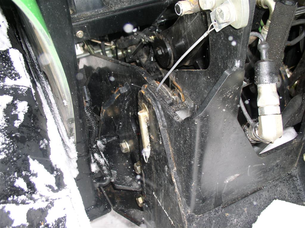

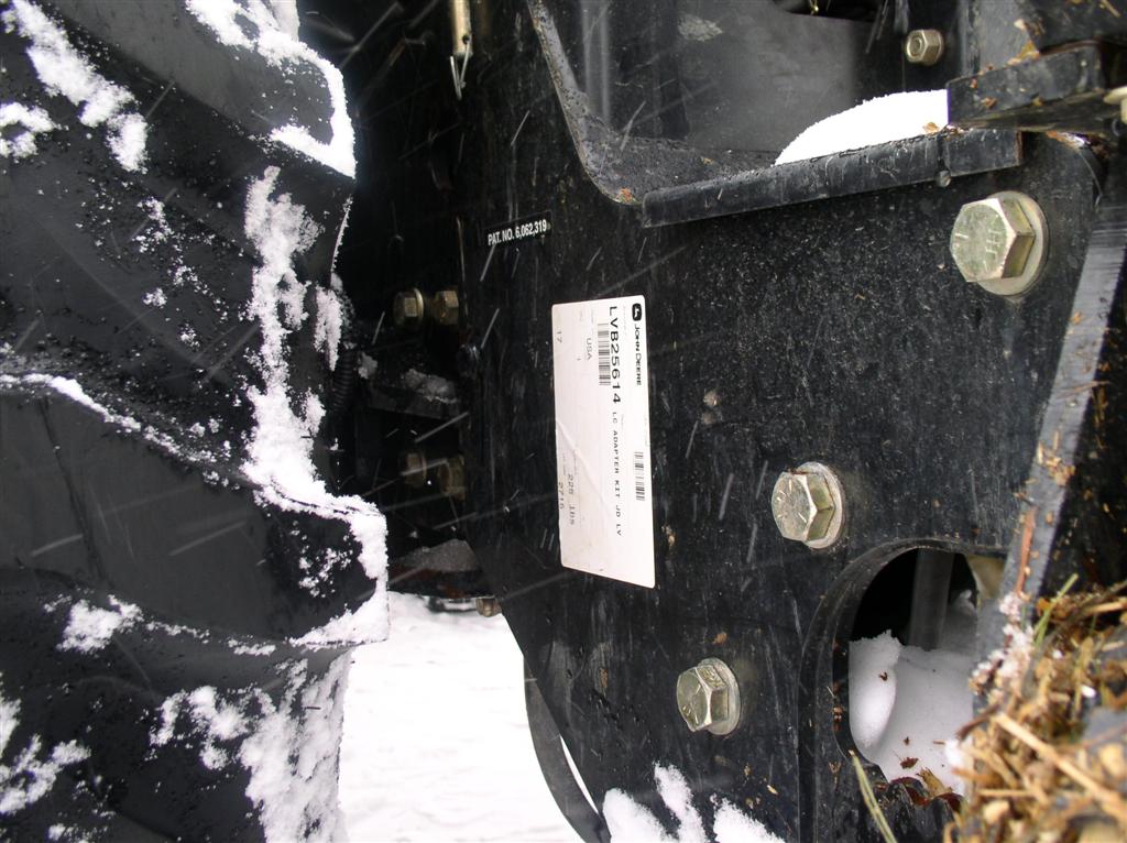

Here's a couple of pics for you, Buckmaster.
The JD system is really quite simple, basicly two heavy plates, one on each side.
There's no subframe.
It is a bit difficult to hook up my I-Match when I remove the 448, as there is limited room to access the lower pins of the 3pt. Not too bad, now I've gotten the hang of it.
Hope this helps.

Thanks for the pics jon!! So i have this straight, you get the hoe off then attach the 3pt to the rocker arms,attach 3pt at the lower end, then the stabalizer and that is it, back to putting the box blade on or what, still having full use of the 3pt system now? Thanks for the help, just want to be sure i get the right one. The woods is giving it a run for the money in my head.
