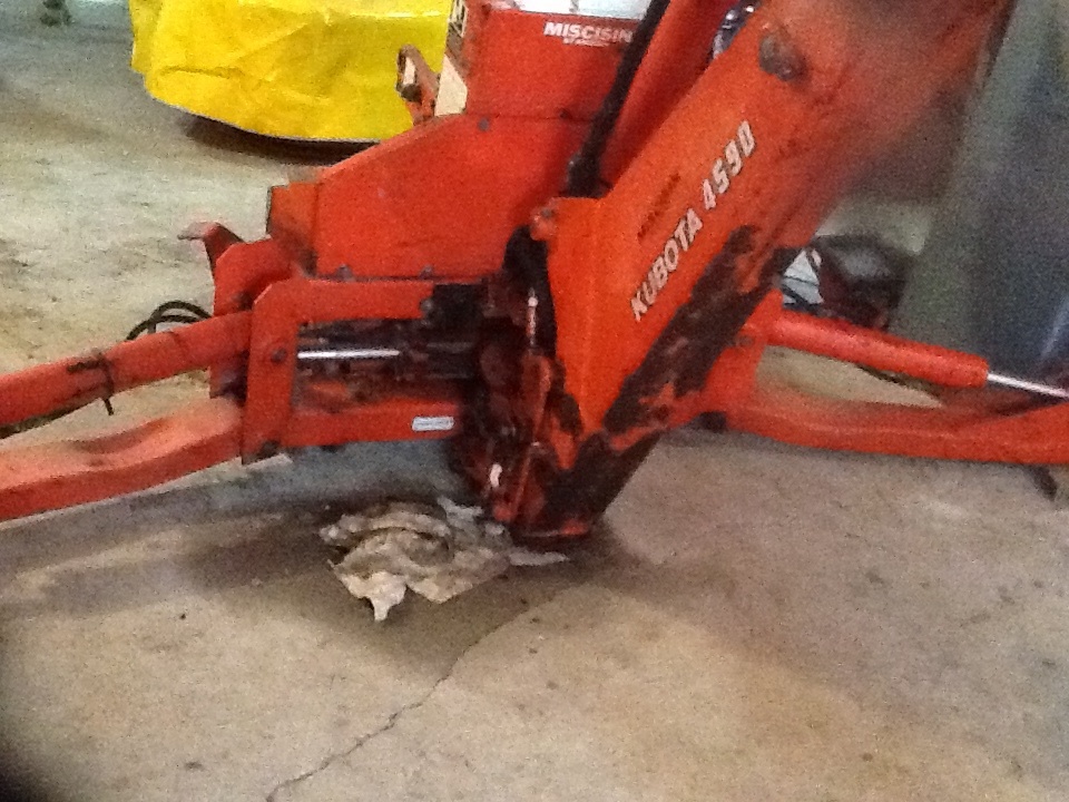

Just a newbie post here. Stored the backhoe over winter and have noticed it go almost totally flat with the stabilizer arms totally extended and rather spread eagle for lack of a better term. So do I simply hook up the hydrolics and lift it back up? Need to tractor jack it up a foot or two? Pic is embedded below. Just checking. Fixing what you broke for not asking hurts more then others.
Yep, that's what I do.
But I lower mine down on to wood blocks after physically disconnecting and just before disconnecting the hoses.

+1 Same here. Have about 12" of cribbing for it to rest on.

This is correct. Hydraulics are going to leak slowly, particularly with something as heavy as a backhoe

Whether it is a three point or a sub-frame mount I believe you can carefully lower the stabs and use the bucket to raise the bh. Do it very slowly and keep the engine at idle. I would make sure there is nothing near it that might get damaged if it were to fall. Good luck!
