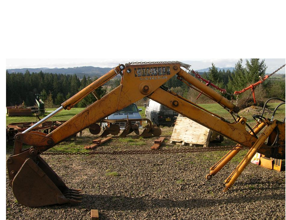

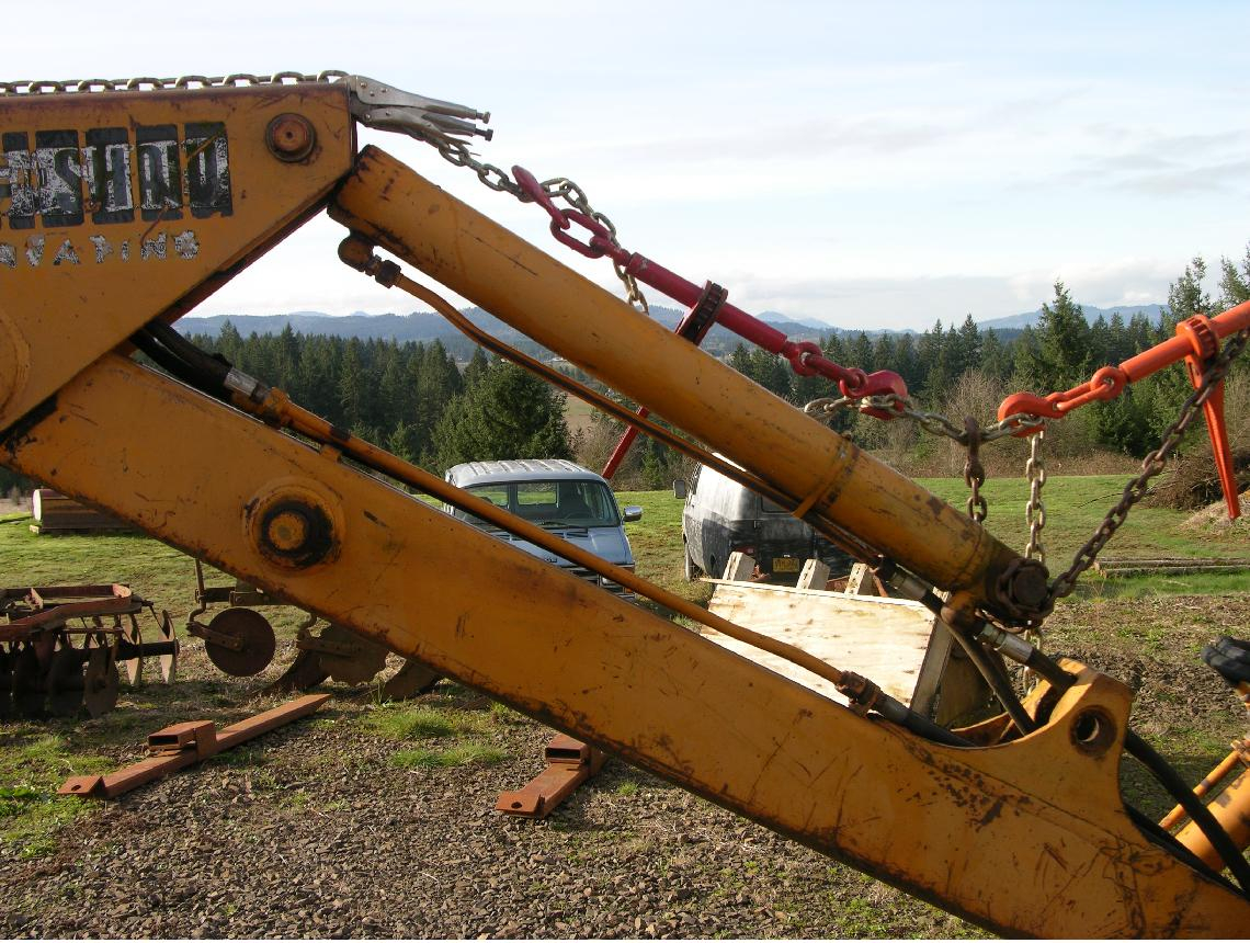

notslow, one more safety related suggestion - the hoe section of these machines weighs about 2 tons, here's what I did to avoid any of the wrong kind of surprises - the chain from bucket to swing tower was attached, then machine shut down, then every hyd lever wiggled till NOTHING moved, BEFORE anything was disconnected.
The ratchet binders/extra chain stuff was just to give easy control of the dipper cylinder (it ain't light) while R&R the hoses. That was done just over 12 years ago when I was "only" 65, next time will probably take TWICE as long :rolleyes: ... Steve
