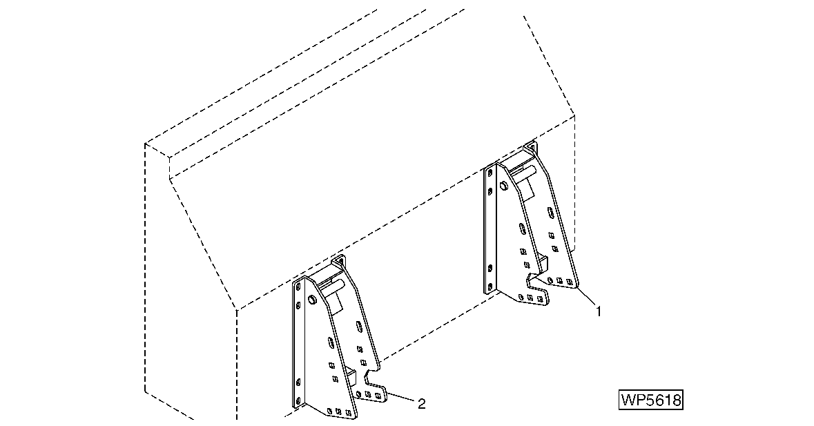

Wanting to buy a pallet fork attachment where I can I find these aftermarket

Does your 620 loader have the JD 600 series quick attach?
   / 620 loader pallet forks not euro style quick attach #4
If you have the spring loaded latch plates on your bucket, they're available, but expensive because the latch plates are sourced from Deere.
The CA wide frame pallet forks can be made, but the build fee is $300 on top of the prices shown on the following pages:

Yes it's the spring latch style
   / 620 loader pallet forks not euro style quick attach #6
Horst Welding (HLA attachments), Frontier has both fixed and floating forks AP12D & AP13D
You can get brackets and latches thru JD parts and adapt Skid Steer forks
