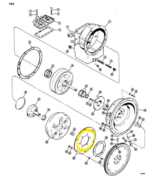

680e case backhoe wont move in forward or reverse
   / 680e case backhoe has know forward or reverse wont move #2
Welcome to TBN.
Did you hear any noises when it stopped moving? I think you might have a broken flex plate, #45.

Have you checked the clutch cut out switch (on loader handle) and/or shuttle spool valve ?

no noise just got in and nothing i guess its a neutral safety switch on dash that says forward and neutral on it you can flip it back and forth and theirs like know resistance kinda looks like it would work off air but i hant removed it yet

theirs no switch on loader handle its on the dash pannel

no not yet i need to get a manual the clutch cut out is mounted by gauges on dash dont know aboutshuttle spool valve

can you bypass neutral safety switch
