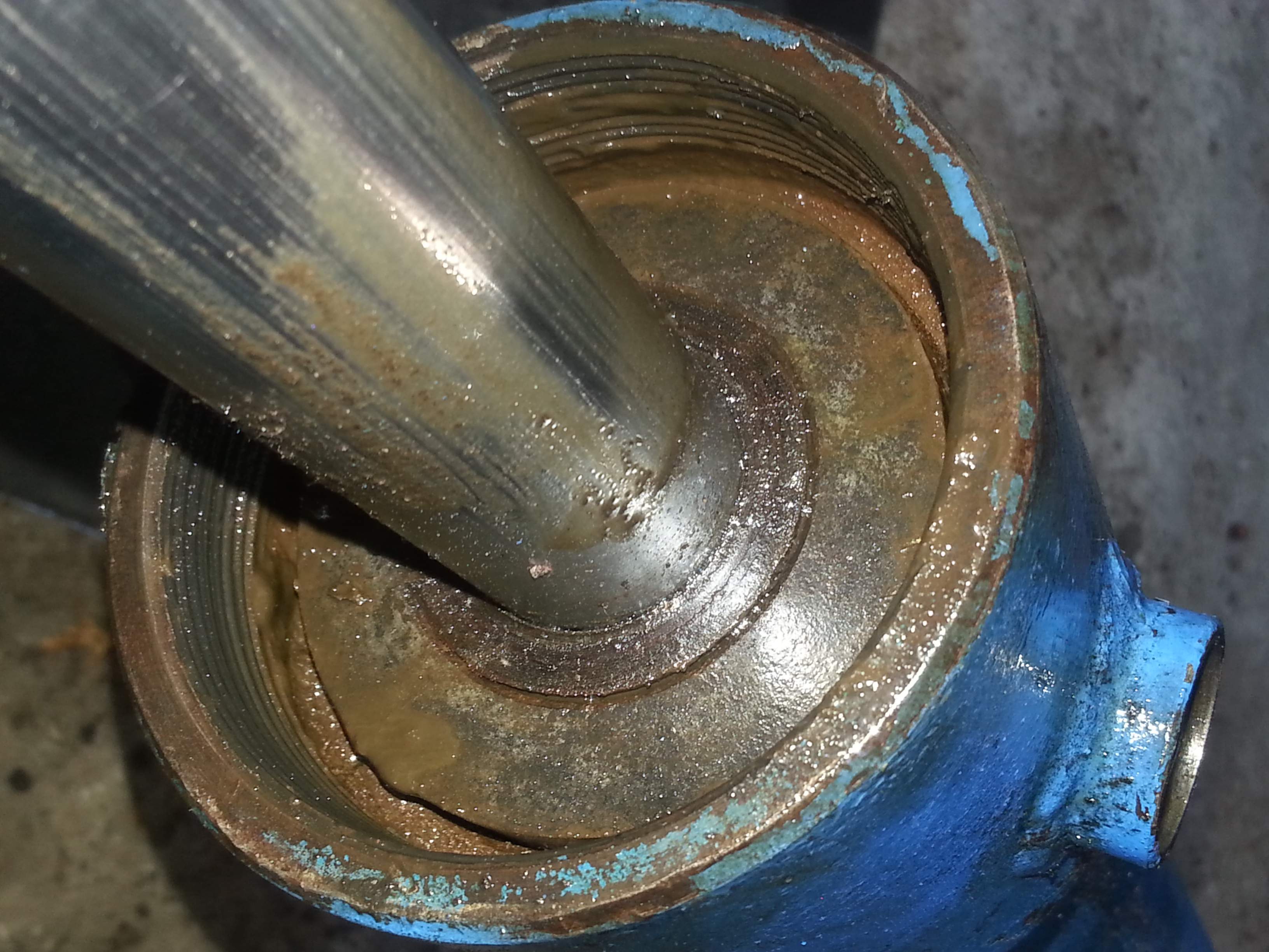

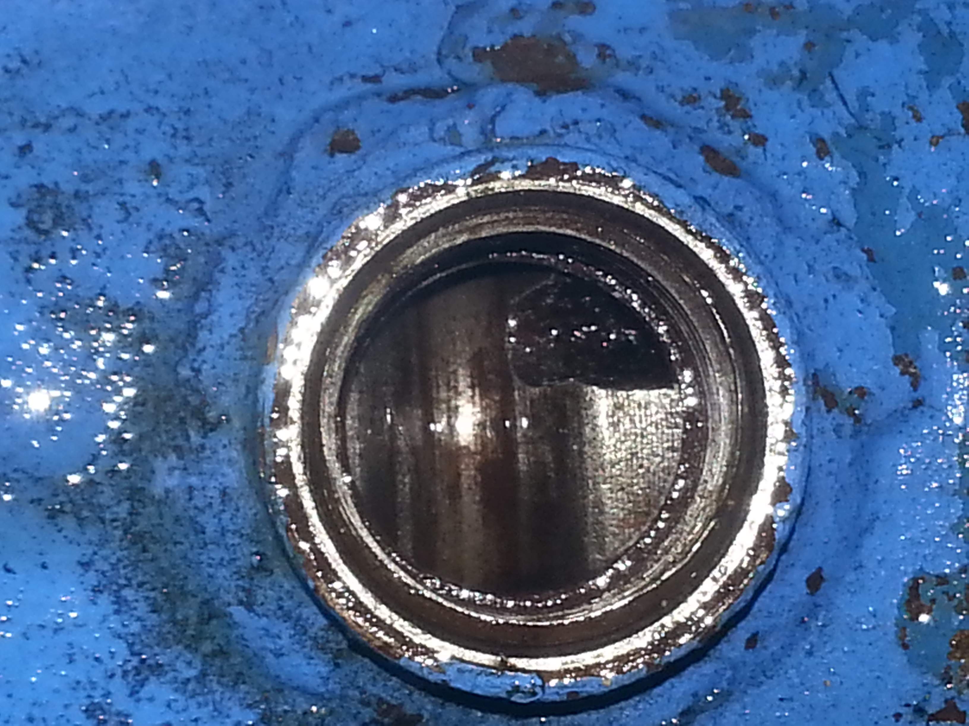

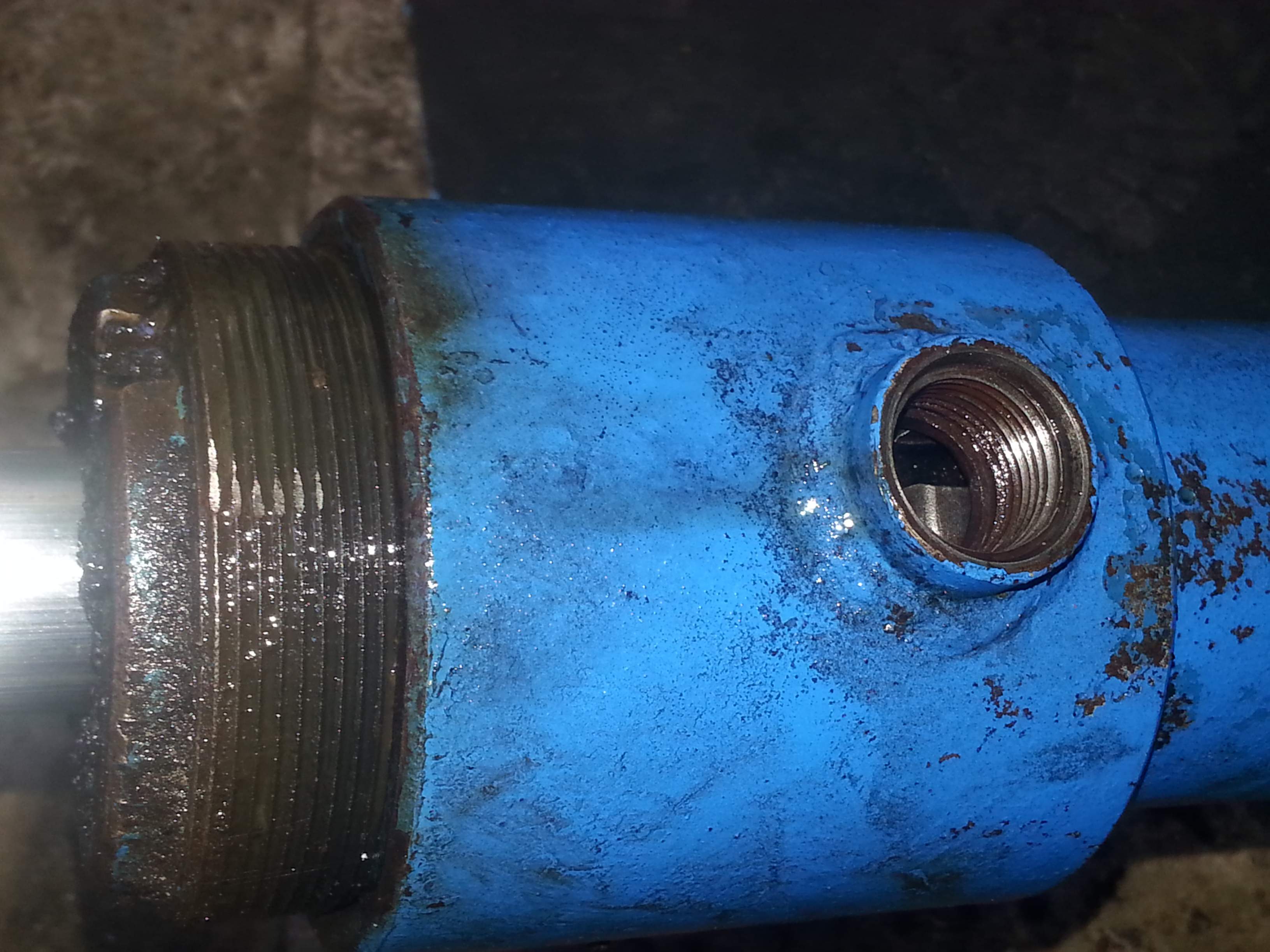

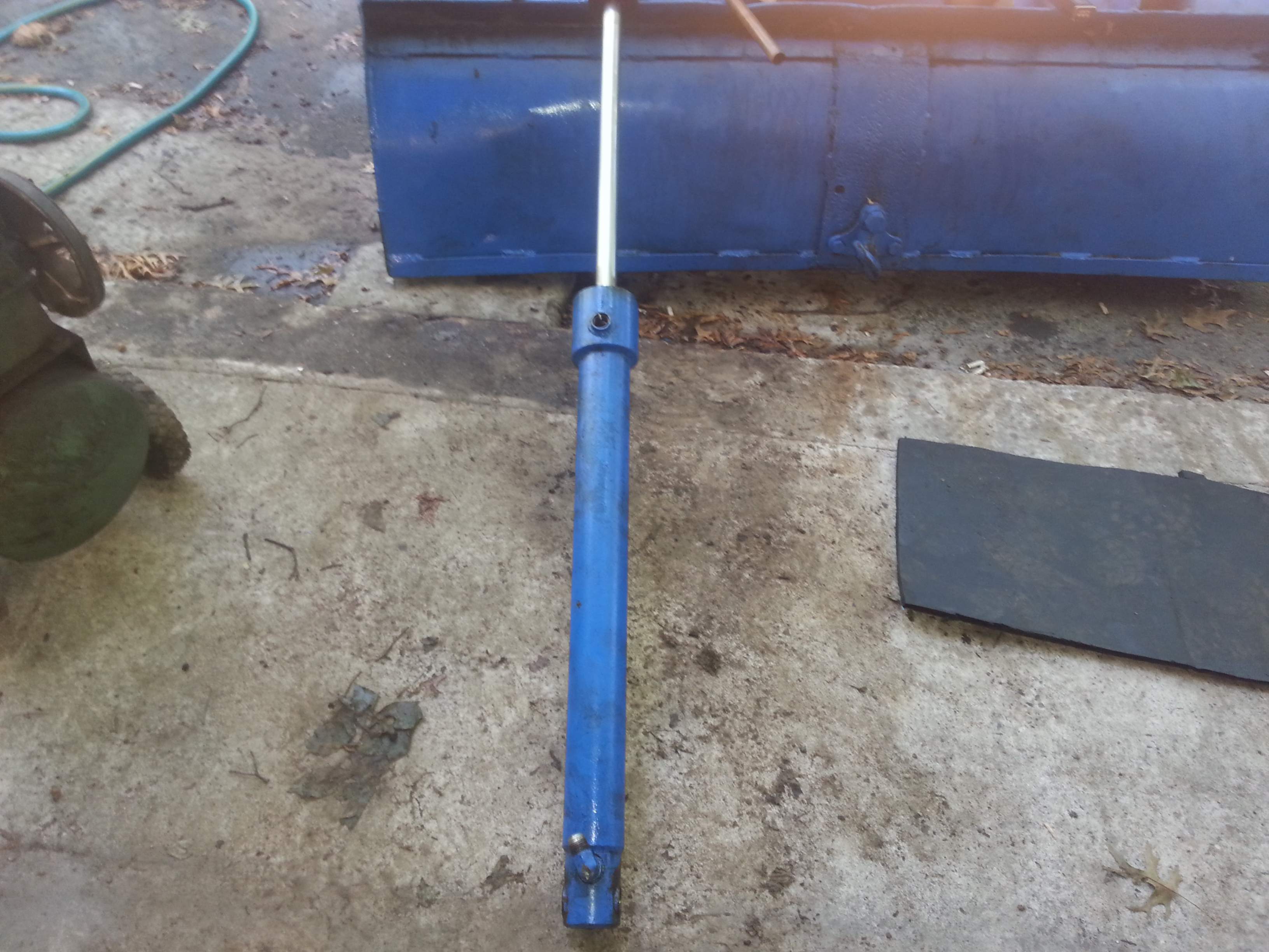

20150814_093846.jpg20150814_093913.jpg20150814_093933.jpg20150814_094045.jpg This is the cylinder in question. It's double acting I presume. Still doesn't seem to want to come out of the bore. I'm wondering if the larger collar that the gland nut screws into is supposed to screw off as well. If so ,I'm a little screwed because it's welded on to the cylinder wall but the other good cylinder is not welded. Also when moving the piston in and out,the metal object in the picture of the hose port does not move with the piston. It's stationary. That's why I'm saying the collar looks like it should come off. Any ideas would be appreciated. Dan

Attached is the parts diagram.
Try heating the sleeve/collar as it appears that water has gotten in and rusted the gland to the cylinder.
   / 720 loader bucket cylinder rebuild?
Thanks to all. I was able to remove it with a good slam to the piston side shackle. Turns out the stainless rod was bent also,having one made as we speak. Thanks for your insight boys. Once again TBN comes through. Dan
