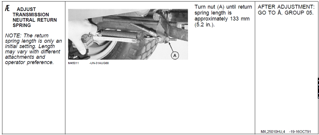

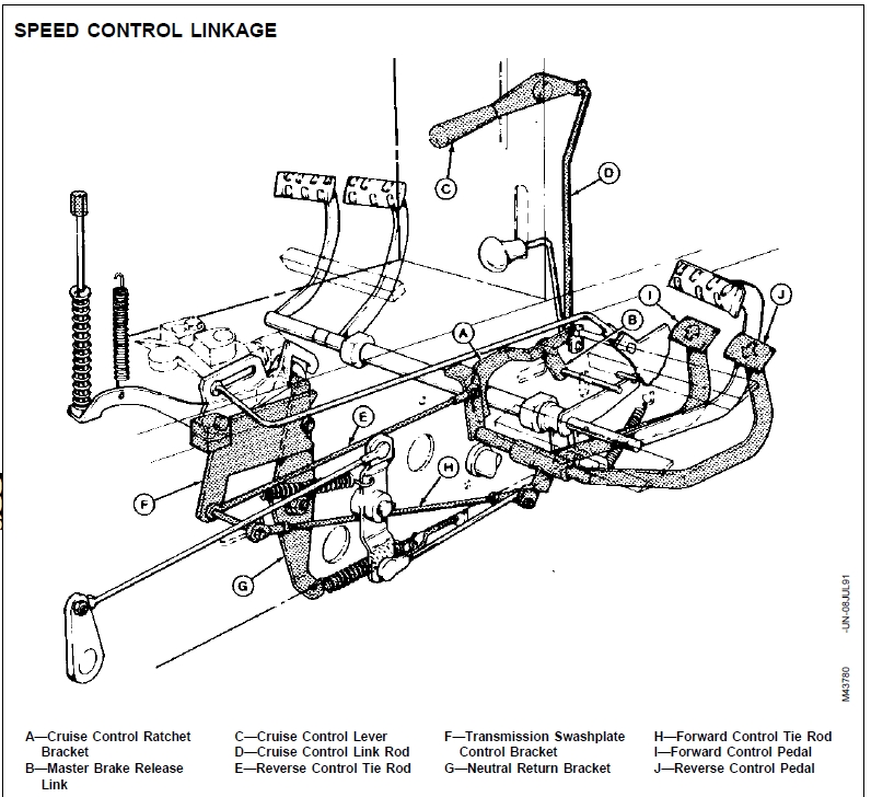

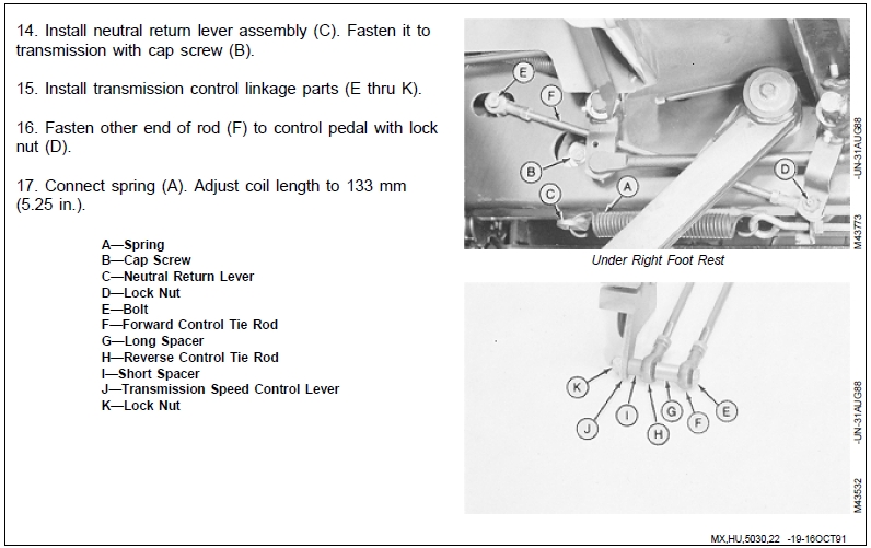

Good evening all. This issue may be related to another thread I opened. Anyway the pedals on the JD have no tension at all. If I press the forward or reverse pedal it just depresses to the bottom of the range but doesn't return unless I push the opposite dpedal. Any ideas?
   / 855 Pedals - no tension #2
Check the spring return linkage under the right side of the tractor. It also activates the neutral switch which must be closed for the tractor to start.
   / 855 Pedals - no tension #3
The spring return arrangement came apart on my JD 4200 while in use. It was rather exciting for a few moments.
Fortunately it all went back together again very easily with no lost parts. :)
