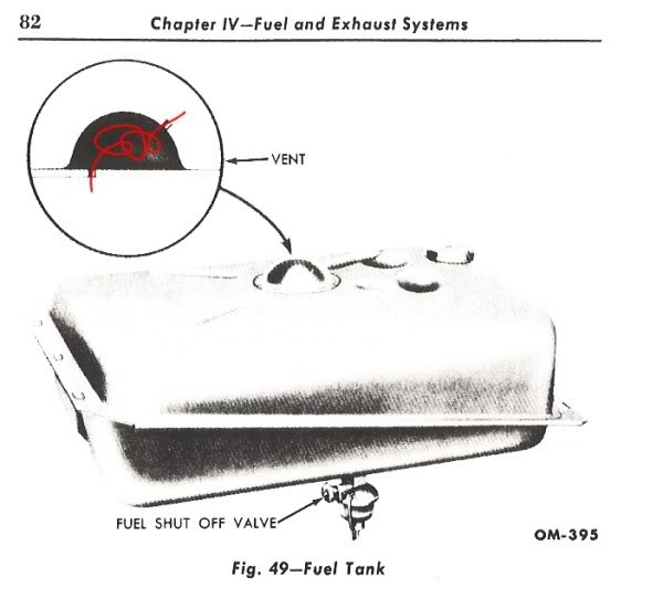

So was running the 8n last night, drove all over the property without issue in 1st to 4th gear. Was extremly happy that it sounded bettter than any other time i had owned it. Went down to the barn and hooked it up to a spreader (ground driven). About 2 minutes into the field it started to bog down and started to learch, die and rev, die and rev, etc. Had to limp back to the barn and switch tractors. This is getting old fast.
   / 8n only runs with full choke #18
Did you check the vent on the fuel cap ?
