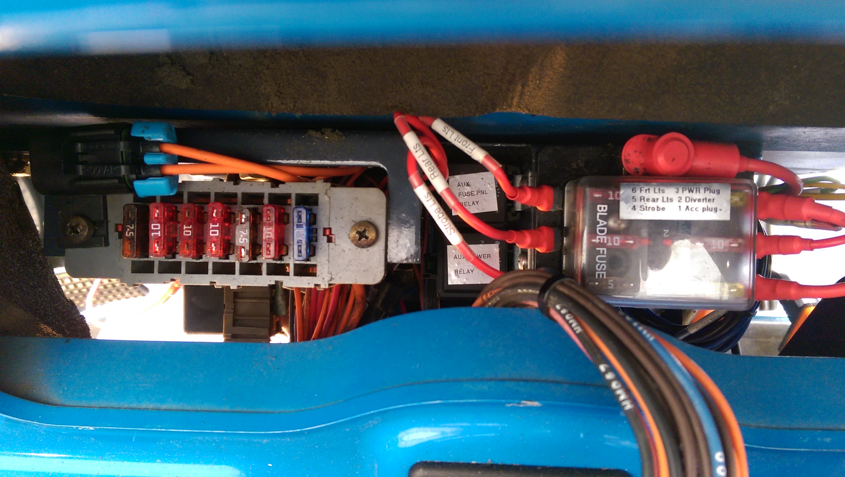

Yes, you just need to power / wire it & fuse it correctly. The Teejet Directovale look like they draw 2.5 Amps per valve so if you are powering all 4 at any one time you need a minimum of 10 Amps for the valves alone then the lighting is an additional load depending on the lighting you use. If you are using LED lights I would guess you are ok with a 20 Amp Circuit feeding your six switches. You can run a new wire from the battery (fused at 20 Amps) to power your switches as a whole or you can wire an Aux fuse block with a fused 20Amp circuit to power & fuse each switch / load individually?

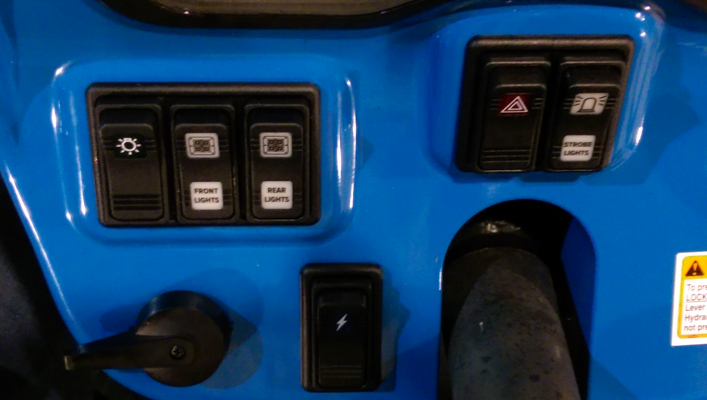

I did the same thing & wound up purchasing CONTURA X series sealed switches from OTRATTTW.net mostly because I could customize the text & they match our NH switches? Not the cheapest but I liked the final outcome. They also sell the bezels to make them look like they are ganged together. I used them to make groups of 3, 2 & a single on our dash ( I think they look factory) but you can do 4 or 6 together easily or break them up as I did.
#3 I can help you with as I don稚 know the unit?
Here are some pics of the switches & aux fuse block I added....

I'd wire off the battery. Large fuse to a new fuse box and fuse each function separately using appropriate size wire. I'd build/buy a switch box to mount on the right fender. I think you have a grab handle you can remove and use those mounting holes.

Chaostamer - So like Michael In Tennessee - "I'd wire off the battery. Large fuse to a new fuse box and fuse each function separately using appropriate size wire."
That is what I would do... Fuse the main feed wire from the battery to the Aux fuse box & then run your accessories from there with their own fuse.
If I looked up the specs on those Teejet Directovalves correctly (@ 2.5 amps each) & you are adding additional LED lights I would venture you will have no issues with the tractor electrical system. The bigger issue would be not wiring it correctly,; for instance tapping into an existing wire for power that isn't sized correctly for the additional load you are adding to it. It is why I Don't like tapping in to the stock harness, whenever possible, manufacturers tend to size circuits & wires based on there expected purpose (load), so they rarely oversize wire.

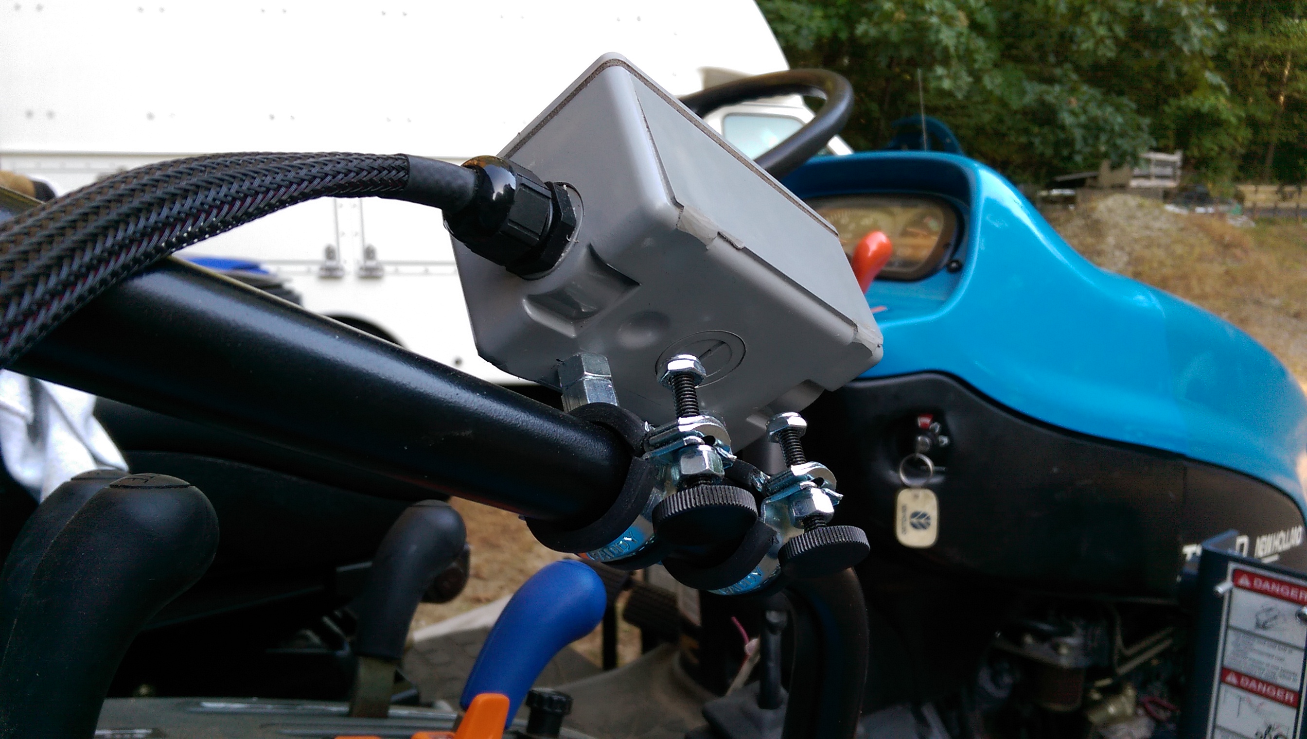

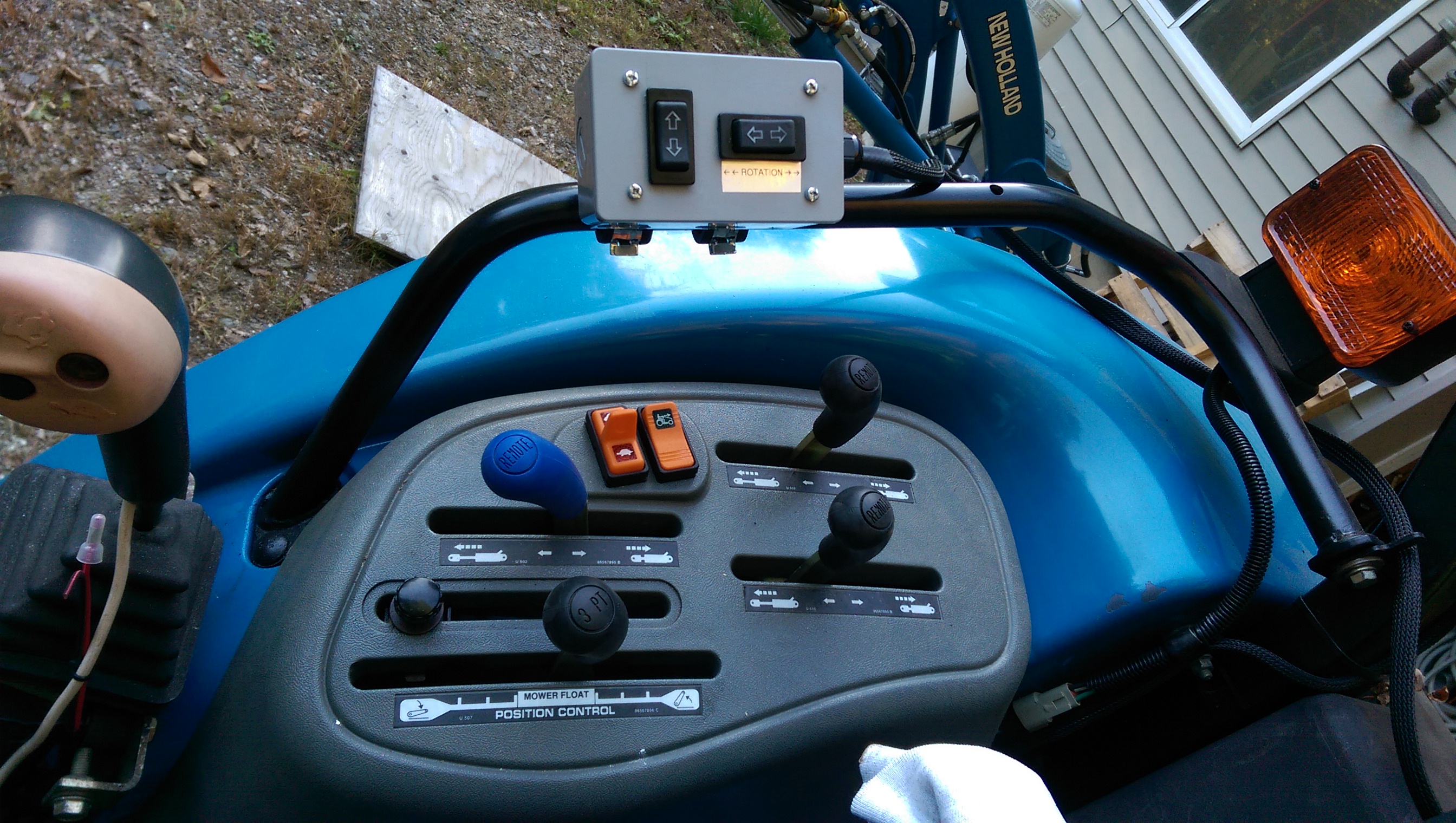

Yes you estimate is correct, the switches I have need a couple inches. There are many lower profile switches out there (I was just trying to match the NH switches already in the dash). Again as Michael in Tenn said you could just make your own control switch box. Does not need to be fancy a simple waterproof electronics box & some switches is all you need like the one below. (they come indifferent sizes)

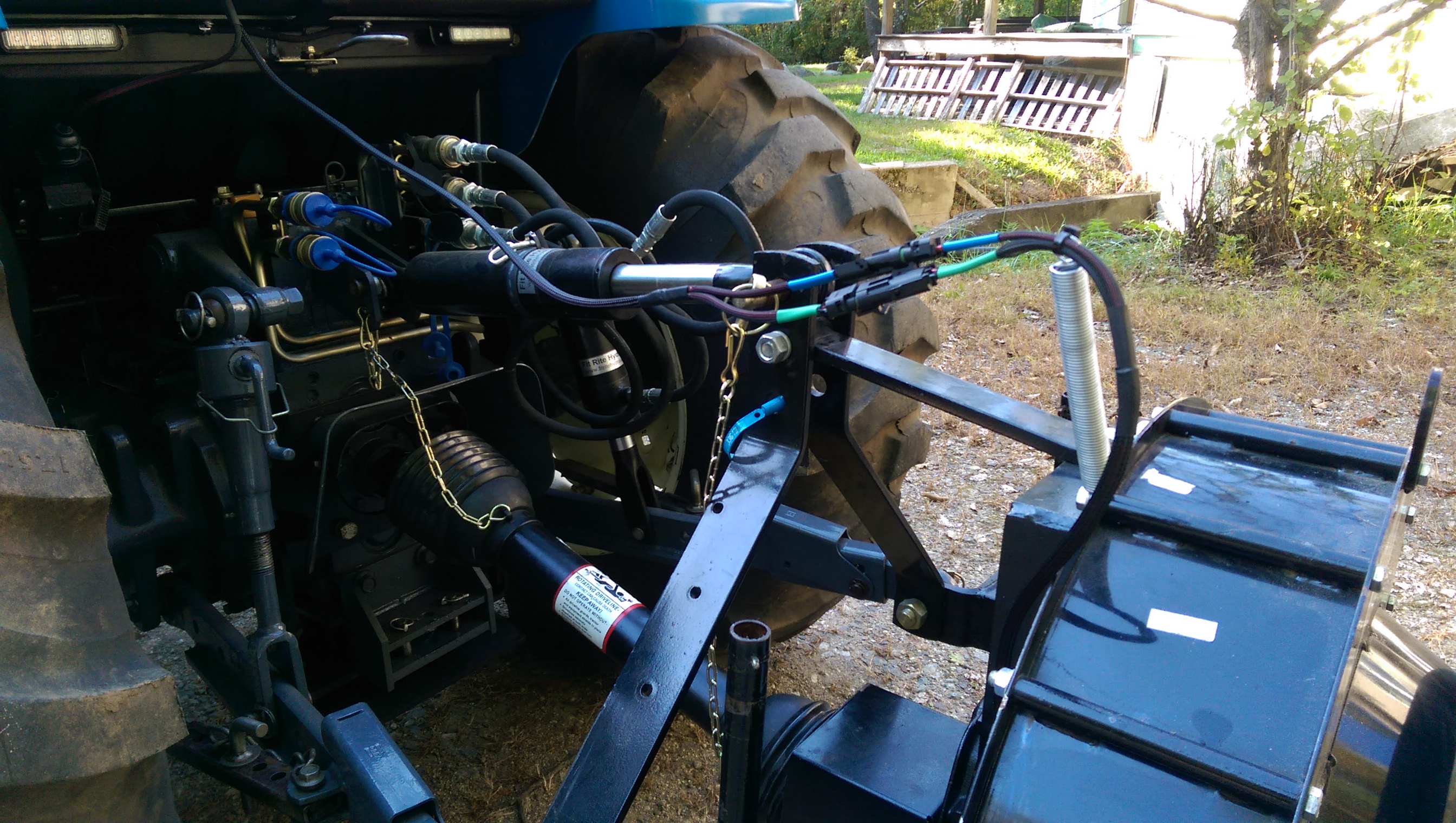

I'v done similar switch box builds for certain implements, like our debris blower. I wanted the switches to stay on the tractor for the seasonal use of the blower, Even when the blower is removed to use a different implement; but then at the end of the fall season I easily pull the switches & harness off to store with the blower. Below are a couple of pic.
It's is just a weather tight electrical box & cover that I added the switches & re-settable circuit breaker to.
It mounts to the handrail / grab-bar with just a couple of swing out pipe clamps & some knobs.
After the switch box is mounted for the season I have 2 disconnects to un-plug & the blower comes off & reconnects easily.
