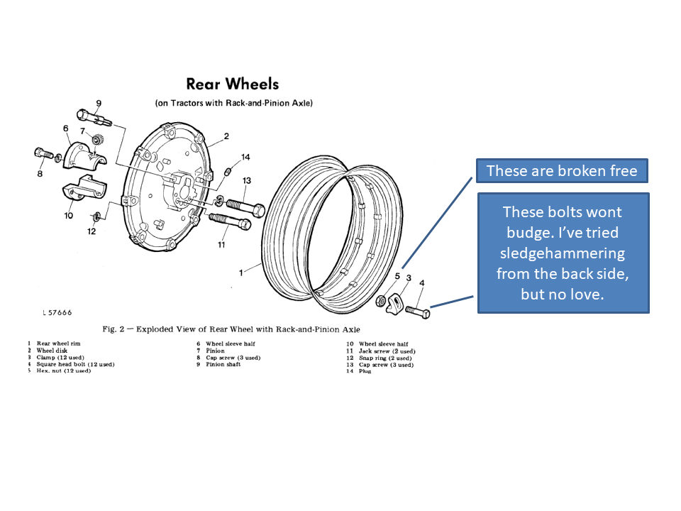

My rim rotted at the valve stem and all the fluid ran out. I've got a replacement rim. The traveling service tech said he didn't want to mess with the wheel due to the wedges being a pain. I've broken the 8 nuts loose (5) and juiced up the bolts (4), but they do NOT want to come out. Any tips on how to get those bolts (4) and clamps (3) to come free from the wheel disk (2)? Thanks in advance!

How long of a breaker pipe(CHEATER) did you utilize on your ratchet/break over?? Do you have access to an impact wrench &/or acetylene torch? With wheel valve stem removed & rear axle jacked up if impact won't remove nuts then I'd heat nut & apply candle wax to bolt threads. Back when I was employed by a dealer I changed frt/rear tire setting on new/used tractors & didn't think it was that difficult. IMHO once the nuts/bolts have been removed the wedges on your type wheels are easy to remove!!! Removing wedges doesn't require rocket scientist mentality or Incredible Hulk strength.!!

Candle wax works great you need enough hear to ‘wick’ the wax through the threads. It does not need to glow red.
If wax does not do the trick, someone may have stretched threads previously, requiring cutting the bolts into.

If I am reading this correctly OP has the nut loose, but the bolts will not come out. There is never any room to get a good hit with a hammer, so they can be a little bit of a pain.
I would put the nuts on loose and drive the tractor a little to see if the wedges will unwedge themselves. Not sure why the traveling "service tech" wont free them up, seems like an issue with the tech, not the job. They are not fun to do, but I have replaced wedge style wheels on much much larger tires before. Always make sure to keep the tractor supported and a skid steer, loader, or crane to keep the tire from falling on you.

Jack up the wheel, put the nuts back on the bolts leaving space between the wedge and back side of the nut. Then it's a matter of hammering the nut/bolt end until one of them releases. Starting at the bottom would be best. If you can get one to move the rest will move (somewhat) easily. Use a LARGE hammer used aggressively or an air chisel with a blunt tool.

I agree with you. IIRC the wedges will come loose with ""bolts in place when rim is moved away from cast center"". It's apparent my reading comprehension wasn't very good when I read op's 1st statement !!!:sick:.

Some times they will pop loose just by striking the rim straight down next to the wedge a few times. Start at the bottom and put the nuts back on like RickB suggested to keep em from flying across the shop. Tractor wedges are cut to where they usually dont fly out like truck wedges do but they can.
