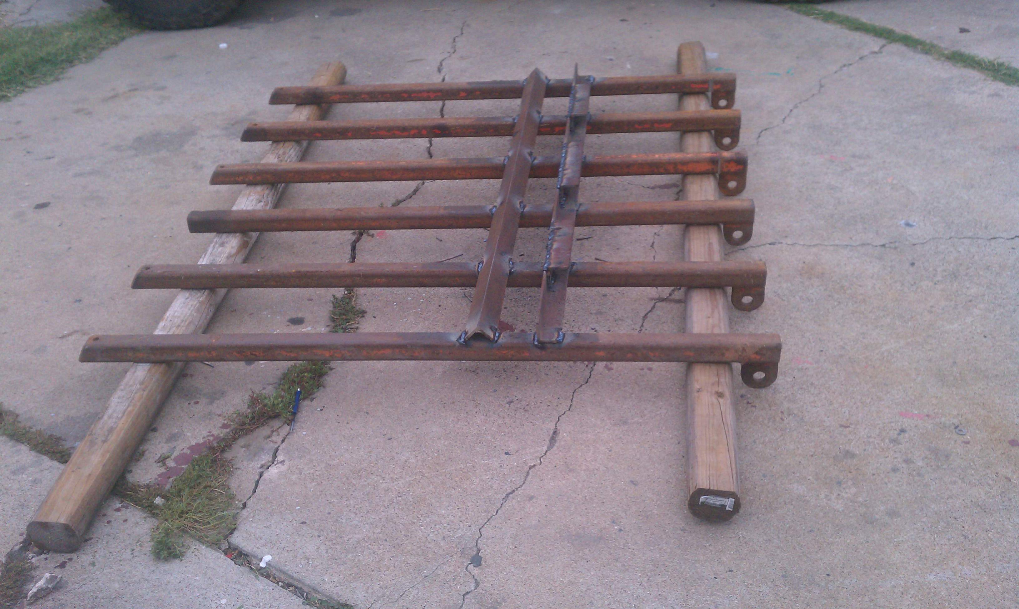

Have read/seen a lot here and finally made some today. All scrap/scrounged up metal, 60" wide and 12" centers on the forks. Using a on 53 hp tractor. First job will be helping clear grape vines off a fence line. I have 18"s that will be under the bucket and the angle iron lip for the front of the bucket to catch. Will be attached via 2" ratchet straps like a ratchet rake setup.
