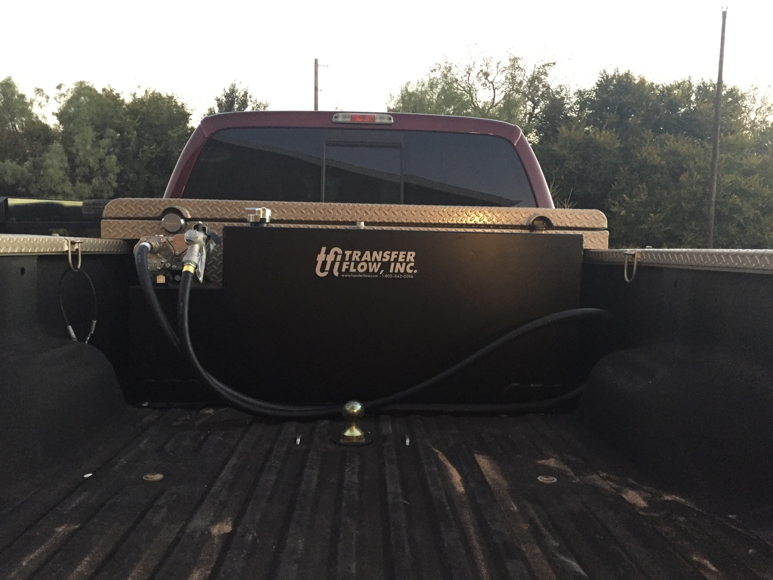

Check these guys out.
In-Bed Fuel Tanks - Transfer Flow, Inc. - Aftermarket Fuel Tank Systems
I use a 50 gallon tank in my truck. Like the low profile and low pump. They make a tank specifically for your intended use if mine isn't low enough.

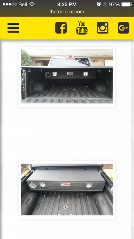

Not sure where to find a picture, but my brother had an L tank in his truck that was level with the box sides and had a tool box built in on top of the L part. The tool box was around a foot shorter on one end and the pump was mounted down in there. I have a vinyl top on my pickup and when I bought it the place I bought it from said they could custom make them to fit any length I wanted. Ok I found it. Not the exact one but same idea.

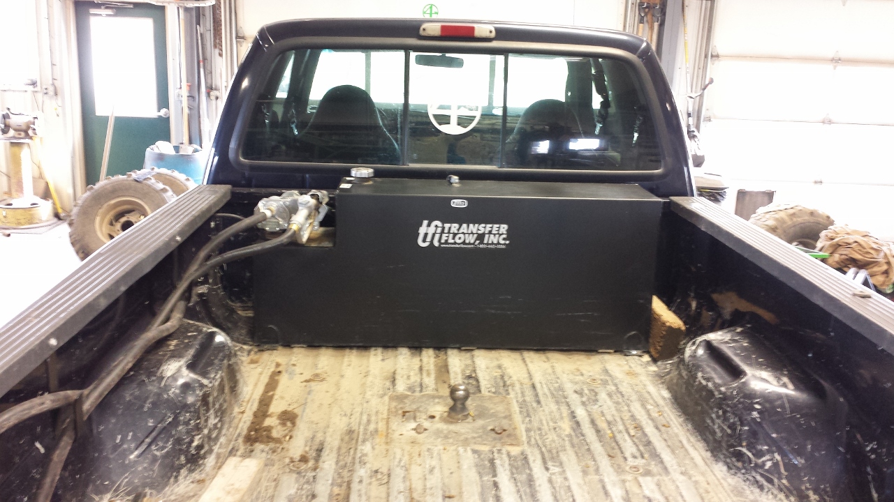

50gal transfer flow, installed myself, really nice unit and good wiring harness. The nozzle sucks but a replacement can be had for 55$ on amazon.
While we're on this topic, what is everybody's consensus on a filter? I personally don't have one as I use biocide and keep my tank full and get good fuel here in Texas.
   / Any transfer tanks that will fit under a bed cover? #9
I have the same tank, love it, beats the crap out of using jugs.
I added a filter. I'm very particular about fuel quality.
