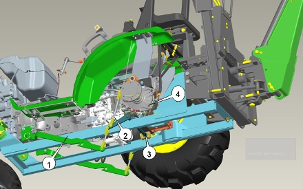

I am also wondering what the salesman said Deere does claim that the two are not compatable. The claim is that the subframe is in the way of the lift system for either mech or ind lift. You will have to remove the subframe to reinstall lift comp for the deck. See the att pictures
legend for ind lift
1. lift arms
2. lower rockshaft and adj links
3. screws and huts
4. hyd cylinder and hoses
legend for mech lift
1. 3 point draft arms
2. front draft arm pivot assy
So a few tools to remove this mower lift system but should not be a real bad project for a once a year or so procedure. I as well would not want to do it all of the time.

The 2305 is different from the other "2" series machines in that it can have the MMM and backhoe on at the same time. The 2320, 2520 and 2720 cannot.
"Well, is there anything for the backhoe that has to be installed/uninstalled (other than itself) before re-attaching MMM bracket and then deck? Or am I only dealing with MMM bracket as issue? If I'm reading your images correctly ctlguy, then I imagine it's only the deck & bracket!?"
None of the "backhoe stuff" needs to be removed to mount the mower.

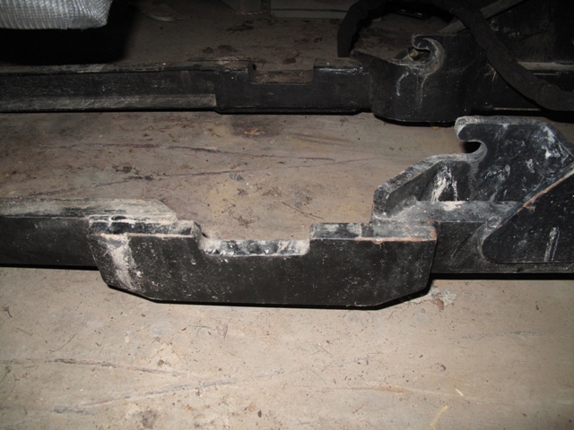

I have independent lift MMM and BH on my 2520. To change from mowing to BH I have to drop mower deck and remove it (quick, no tools), remove blower, bags, etc and any parts of 3PH I have on. After deck is off then just bring lift arms for deck back to 'up' position. Then back up to BH and test myself how accurately I can line up to pick it up. Hookup BH
My dealer made a small modification to the underframe of the BH mount - two small notches in the frame were cut and then additional steel was put to strengthen this area. This was done with Deere support for modification, when I originally bought my 2520.
Hope that addresses your issue.

Am I to understand that "This was done with deere support for mofificarion,..." was done for the purpose of NOT having to remove the MMM bracket? If so......this is like an awesome possibility for me to pursue.
When you mentioned removing parts...3pt...in particular, was this for the independent lift? I am not getting the independent lift....just FYI!
I wouldn't be surprised if others on this thread may find some curiosity in this!
Hmmm, and Deere supported! :cool2:
