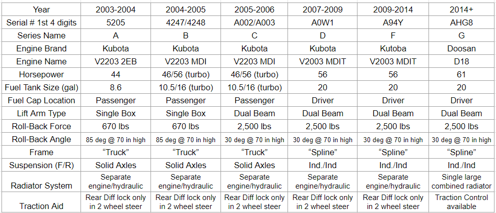

What Series do you have?
Toolcats have been around for twenty years:
   / Blowing fuse 2 sw power on toolcat 5600
Its a series A toolcat
