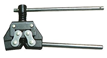

Got a fist size rock stuck between the chain and sprocket on my snowblower tonight and broke the chain. I would have thought that the shear pin would have gone first but it didn't. Tractor Supply had the chain in stock (10' more than twice what I need). It's 60h chain and it came with a master link but I would rather rivet the chain back on. Does anyone have a good suggestion for a breaker (was looking at a Koch). I have a breaker for motorcycle chains that just isn't quite large enough but it will push the pins out then drive them back in. I assume that the Koch breaker will not push the pin back in since it's a different style. I wouldn't mind a riveting tool but have used a hammer to peen the end of the pin. Here's an image of the Koch breaker.

Standard roller chain is typically not riveted as a repair. Use common connector or offset links using cotter pins or clips to retain. There are two sizes of chain tools similar to the one you pictured. One is good up to #50 chain, the other from 60-100. In the absence of a dedicated tool, grind the rivets flush with the side strap on one side and drive the pins out with a punch.

Grinder, punch, master link, done..

I figured from your OP that riveting chain links was SOP in the cycle world. In my world (farm and CP stuff) it is not; hence my reply. Cottered connector links are better than those using clips, but the clip style is far more common.
