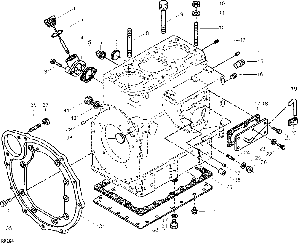

Got it torn down this morning. Thankfully, I didn't see any damage to the block at all. We are taking the head and block to the machine shop to get checked out. Also going to get the machine shop to replace the cylinder liners and main bearings while they have it there. I have rebuilt a couple of engines before, but I don't have much experience at this. I did find a service manual on ebay and ordered it so maybe that will help.
As far as the cause of the broken crank, I didn't see anything. When I pulled the head, I didn't see any signs of anything wrong. All three pistons and cylinder walls looked equally good. There was no signs of the head gasket leaking or any signs of fuel problems.
Also, the tractor was running fine until this happened. So, maybe the crank had some minor imperfection that caused the crank to fail due to high cycle fatigue. I'm a mechanical engineer at an old plant. Sometimes I see things like this, something breaks and can't find the cause. We send the broken parts to the lab. They can identify the failure mechanism. Sometimes it was caused by 40 years of vibrating back and forth.
But anyway, I'm about to order the parts. I'll take better pictures as I'm putting it back together. Will probably be next weekend.

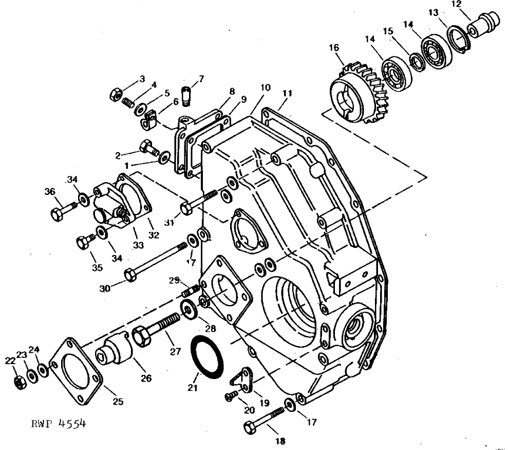

#20
Well, we got the engine back together and the dealer put the tractor back together. The engine is running fine and everything is good, except, now the hydraulics don't work. The frontend loader and lift don't do anything. The dealer says they checked everything and the pump is spinning, but isn't pumping. They said the only thing left to do is replace the hydraulic pump. It was working fine before the crank broke and we didn't do anything do the pump. We just took the timing cover off of the engine and the pump is attached to that cover. Is it possible for the pump to just stop working like that?
