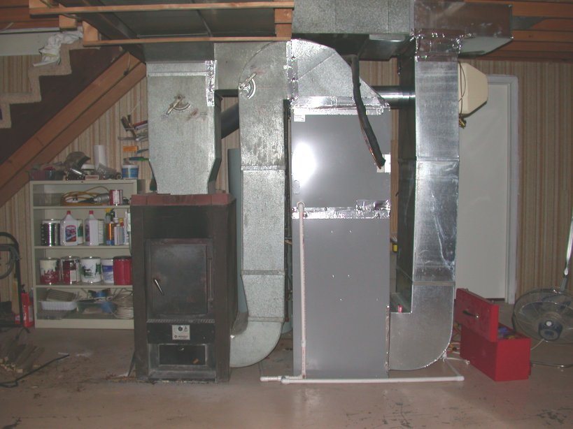

Anyone have a wood burning furnace which is tied into the gas furnace?
I have one-installed new with the house in 1975. The wood furnace an old Monarch brand, called Add-a-Furnace. Parts are extemely hard to find, but Ive found a few. Ive heard and seen a few Longwood furnaces, too.
Just wondering if anyone has a wood furnace that they purchased or built or if anyone is familiar with Monarch or Longwood?

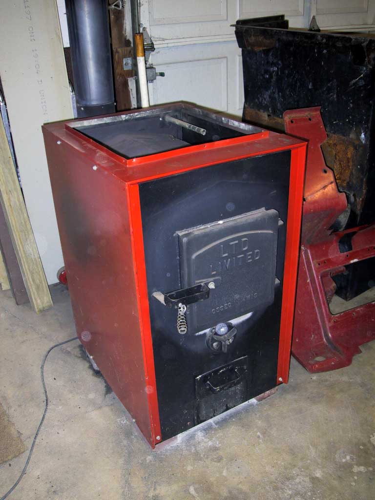

Dwight,
I'm not familiar with either. I have a LTD Limited add-on furnace which I bought about 15 years ago used. The door says Osseo WI on it. Uses a small Dayton squirrel cage blower. Up until last year I had it in my shed. I replaced it with the idea that I would move it down to the house and tie it into our existing H.E. forced-air gas furnace.
That plan has gotten waylaid a bit for several reasons:
1. I would need to move my existing furnace from where it sits. The estimate for our local HVAC company to do so was around $500 to $750.
2. I currently have a natural gas water heater which vents into the flue I would use, so I would probably need to move it and/or come up with a different venting scheme. More $$$.
3. The basement room where I would be locating the addon doesn't have a door to the outside, which makes getting wood into it a bit of a problem. (The only path is thru a family room in the which currently has a white berber carpet /forums/images/graemlins/grin.gif)
4. I already have a woodburning insert in the basement fireplace - although it isn't the greatest unit (it's a Good News), it does provide a significant amount of supplemental heat.
5. We're putting up a polebarn (they start tomorrow) and I'm thinking of just locating the unit there.
One of the things I did after pulling the unit out of the shed was to "port & polish" /forums/images/graemlins/grin.gif the draft vent to open up the holes in it. When I had it in the shed it was always starving for air - in order to get the fire going good in it you had to open the ash cleanout tray slightly to give it enough air - hopefully it will work a little better now. One of the problems with the design of this unit is that they ash cleanout tray does not have a door that locks closed on it - the tray just slides in and out. It would be very easy to over-fire it if you weren't careful.
Attached is an image.

I used a Monarch Add-A-Furnace for twenty years hooked up just like yours. I burned about twenty face cords of wood a year and not much propane . I thought the furnace was pretty darn good. I did have to replace the cast iron liner plates a couple of times, but the last time I tried to replace them, my dealer told me he couldn't get them anymore.
When we were getting ready to sell our house, I replaced both furnaces with a high efficiency gas furnace, and the old Monarch was carted off to the scrap yard.

When I eventually relocated my old add-on to my barn, I removed all the shrouding, insulation and the blower, so I didn't have to have that noisy blower going all the time. To provide a little better air circulation, I put a ceiling fan in the ceiling above and have it on low speed. It not only helps to distribute the heat, but also does a better job at keeping the whole barn warm, and its oh so quiet. I've only got 3-1/2 inches of insulation in the ceiling, but it's not uncommon to get my 30x40' barn up over 70 degrees.
