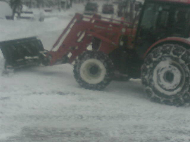

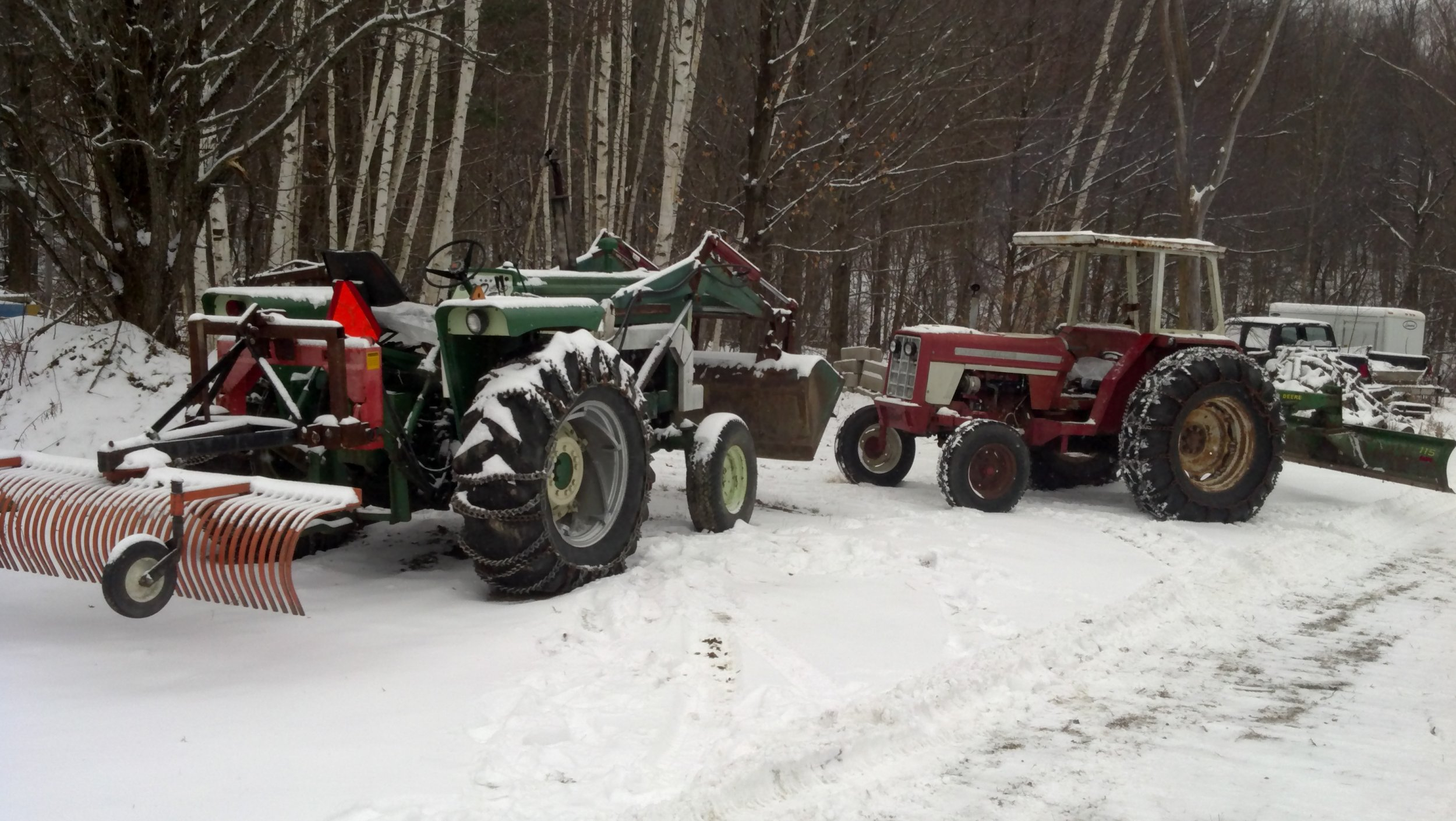

Two wheel drive with good chains will do snow work,
it is certainly not as nice or fast or stout as the same size four wheel drive.
As far as a loader call the aftermarket vendors and just see what a new loader would be.
I did a lot of snow removal with these two wheel drive tractors on a very steep driveway,
steep enough that to stop the Oliver on snow or packed snow you used the bucket down pressure.
After I got my first set of the Euro style studded chains, completely different stop and start any where's.
A four wheel drive is much nicer and handier;

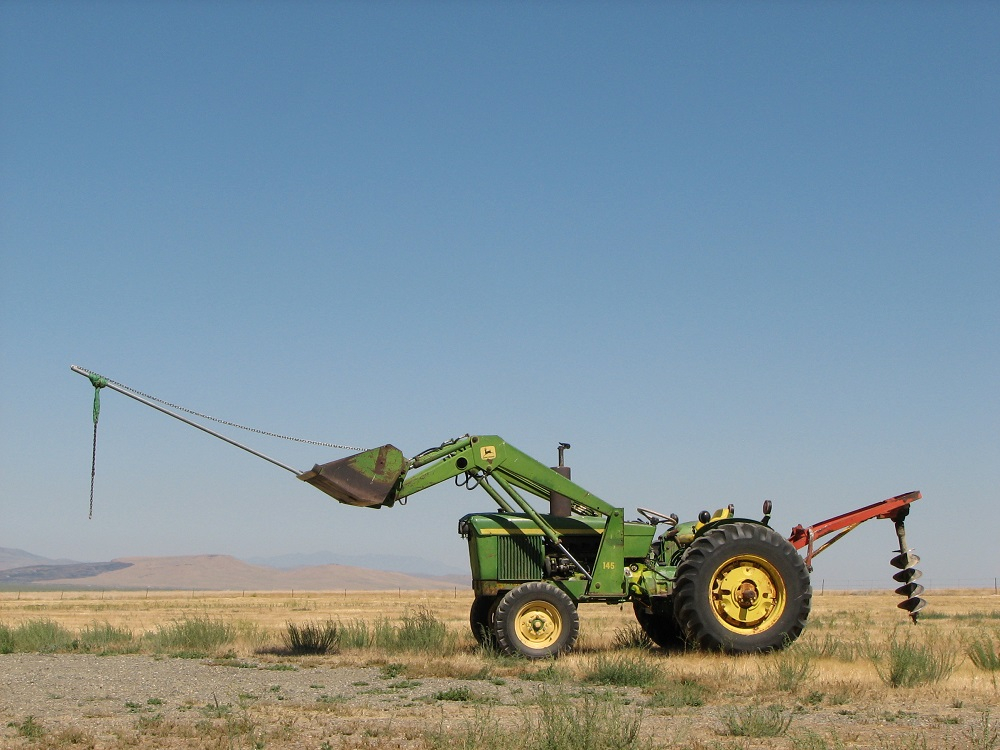

I bought my JD 2020 diesel over 20 years ago and am still using it today. Got it at a ranch auction - and it was in sad shape. The seat assembly had rusted out so the previous owner had substituted a block of wood and a pile of rags! The hydraulic system was fill of chaff - I had to drain and change the hydraulic oil and filters many times. But it came with a JD 145 front end loader, and that is a good combination. I use that loader almost daily it seems like.
My tractor has the same tranny as yours...except that mine has an optional "hi-lo" shift lever on the left side of the dash under the steering wheel. Other tractors had a true "reverser" which would allow forward and backward travel without using the clutch. The "reverser" lever was also located on the side of the dash, same place as my "hi-lo" lever.
I don't find the location of the 3-point lever a problem. The lever that irks me is the control lever for the PTO - right next to the gear shift lever. All too often when I want to shift the tranny I brush against the PTO lever and disengage the PTO.
Can't speak to aftermarket front end loaders but the JD145 loader on my 2020 works excellent and is extremely sturdy. I've found I can lift close to a ton with it - the limitation is that without 4wd, a lot of weight in the bucket and I can't back up if in loose/soft terrain because the rear tires will just spin (no liquid ballast in the tires).
If you take the tractor to Alaska - make sure to put a block heater of some sort on it. Mine will not start if the temperature is anywhere near freezing without being plugged in for an hour or so. Put some ballast on the rear and get tire chains and it will move snow just fine.
As I said, I've had mine a lot of years and have put a lot of hours on it. So if you have further questions about this particular model I'll help if I can.
