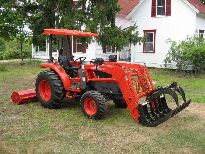

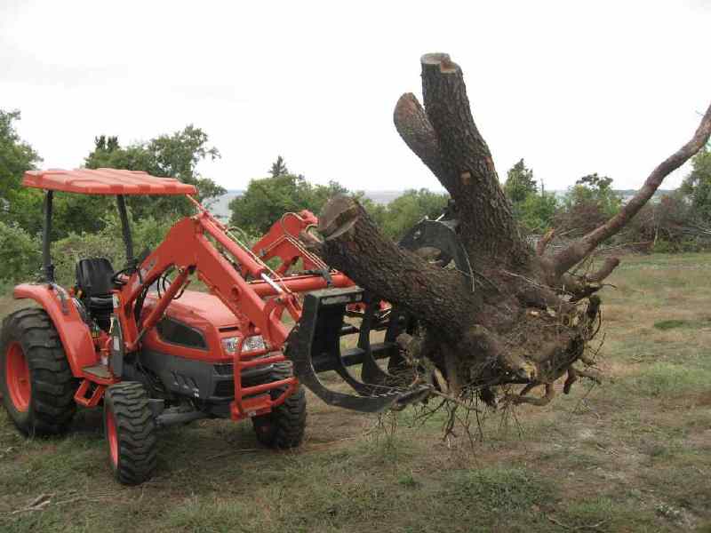

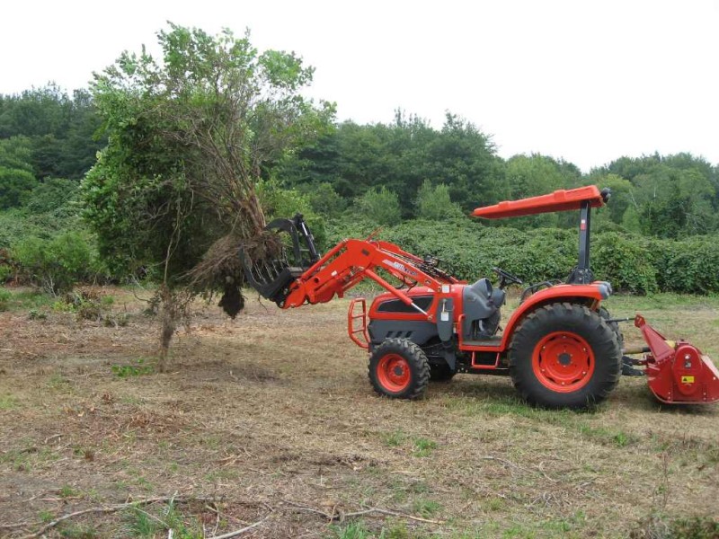

This is my 41hp Kioti DK40se set up with grapple and flail mower. Does a great job in clearing land. Kubota, JD, NH, Mahindra all have equivalent machines. In that size machine look for loader strength (minimum 2000lbs lift) as well as HP as you will be doing a lot of lifting and ripping in addition to mowing. The smaller tractors also work but if you have a good loader in this size range you can do a lot directly with the loader/grapple that you'd otherwise need to spend several times as much effort on.
