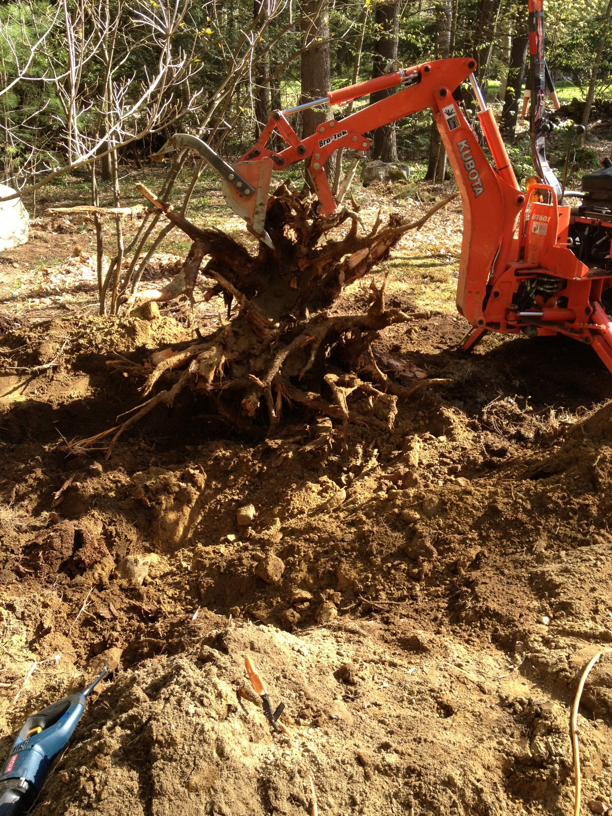

I have a Bro-Tek on my BX24, and wish I'd bought it two years earlier. Mechanical works fine for me. Very useful tool, and enhances the BH capabilities dramatically. In the photo, you can see the ripper tooth I bolt on for larger stumps, which allows me to pierce inward and strip away the soil underneath the stump. It breaks the stump free much faster, given the limited power of the BX hoes.
