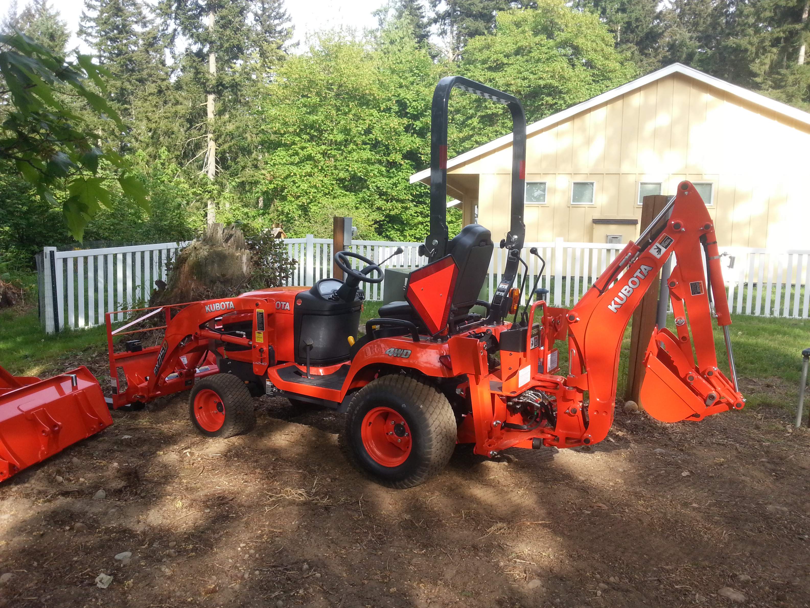

I just got a call from my dealer , my thumb is In, they just need to come out and install it! I'll post some pics. While clearing we found a lot of boulders that will need to be moved....I can hardly wait. Wait there must be something wrong with me ...looking forward to work?

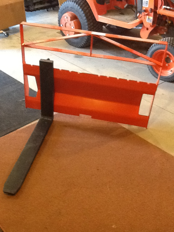

...now tonight I need to disassemble it and weigh it on the fish scale and see if it's really pushing 250#.
sea2summit - did you get a chance to weigh up your forks? Just looking for another data point (in addition to vanb's) on the weight of the Kubota forks with the frame to compare it to the EA version. Just looking at pic's of it, it doesn't strike me as weighing 250 lbs, but that's what vanb's total to. Thanks

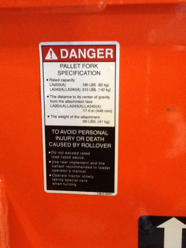

The carriage says it weight 90lbs. right on it. When I weighed the forks they really came in at 81lbs. each. I also needed to order the large center pin from my dealer to put on my bucket( one came on the fork carriage, not sure if another one should have come with the QA). The forks came in 2 days, the pin ( pin 3) took a month and was on back order.
Sorry got bussy and the weather has been crap and my little garage isn't condusive to moving some of that stuff around without pulling one of the toys out first. Looks like vanb had the info. They don't feel heavy up there too me and I put a big stump on it and they lifted it so weight I don't have issues. I do know they are built like a tank, you can lift the front of the tractor up on just the forks no problem.
