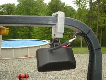

Before this turns into a thread about how to mount lights on the ROP. I found a quick easy way to attach your light without welding or drilling into the ROP. I took a clamp from a truck cap and bought a longer bolt. It clamps down great and no worries about the ROP "integrity". See the attached picture.

another shot of the completed install
