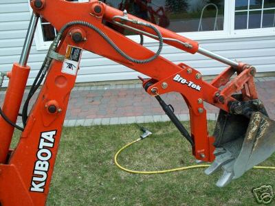

Referencing the attached image, I see three parts to the thumb installation.
1. The orange triangle that bolts to the BX arm
2. The orange thumb that pinches items against the BX bucket
3. The black cylinder
Are all three included in the purchase?
Thanks Again,
The Gardener
   / BX24 - Home Made Thumb #5
Hi Gardener,
The black cylinder is the Top-Link, which normally comes with the 3 point. It works like a turnbuckle, giving a wide range of adjustment.
Please advise me if the 3pt comes standard or not, with the BX24.
The Top link does not come with the Thumb. The Thumb for the BX are made for the BX22,BX23 & BX24, they come complete with bolts & pins , except for the Top-Link, which I would recommend getting the 3pt kit from Kubota.
