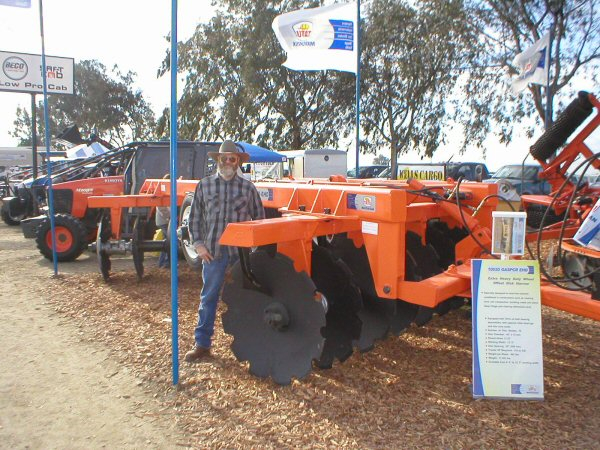

So no matter what this set weighs and no matter that they sink into the ground well over 12", as long as the angle is set straight pretty much any tractor can pull these? :unsure:
   / Can My Tractor Pull XXX Tandem Disk Harrow?? #10
Any disk with them set straight will have a certain pull requirement in a specific soil. As the angle of the disks increases the pull requirement goes up.
