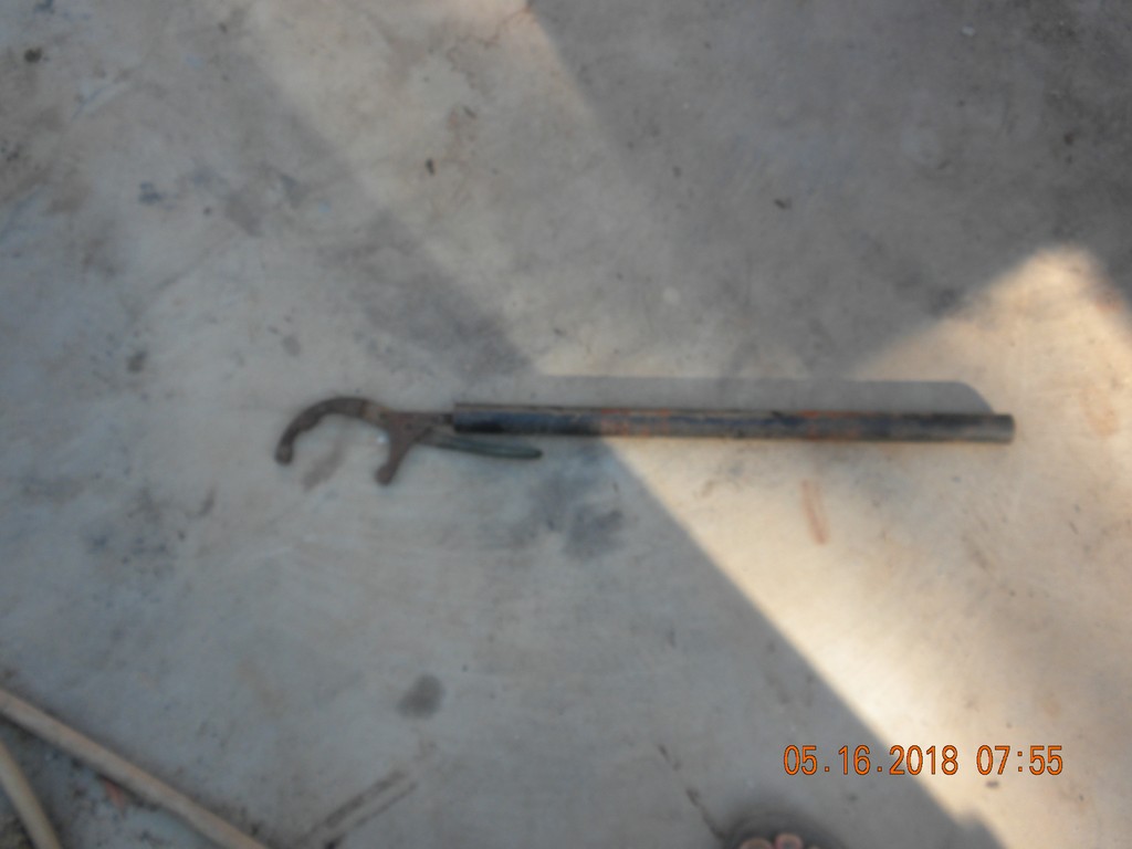

You WILL NEED this tool........and a cheater bar:

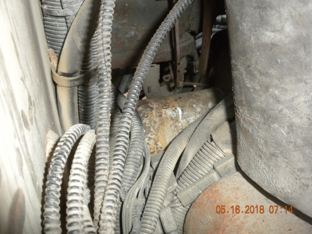

You can move some wires away, and a hose or so, and there will be enough room to remove and extract the old filter.
Pull it out with the open end first.....you can put your finger in the center threaded hole to help remove it........it's a very tight hole that you're gonna be pulling it out through.
I got that filter wrench on it, but it was so tight I had to use a cheater bar to get it loose. Luckily those kind of filter pliers will 'lock' up so you only need the cheater on one handle.
Here's the old one:

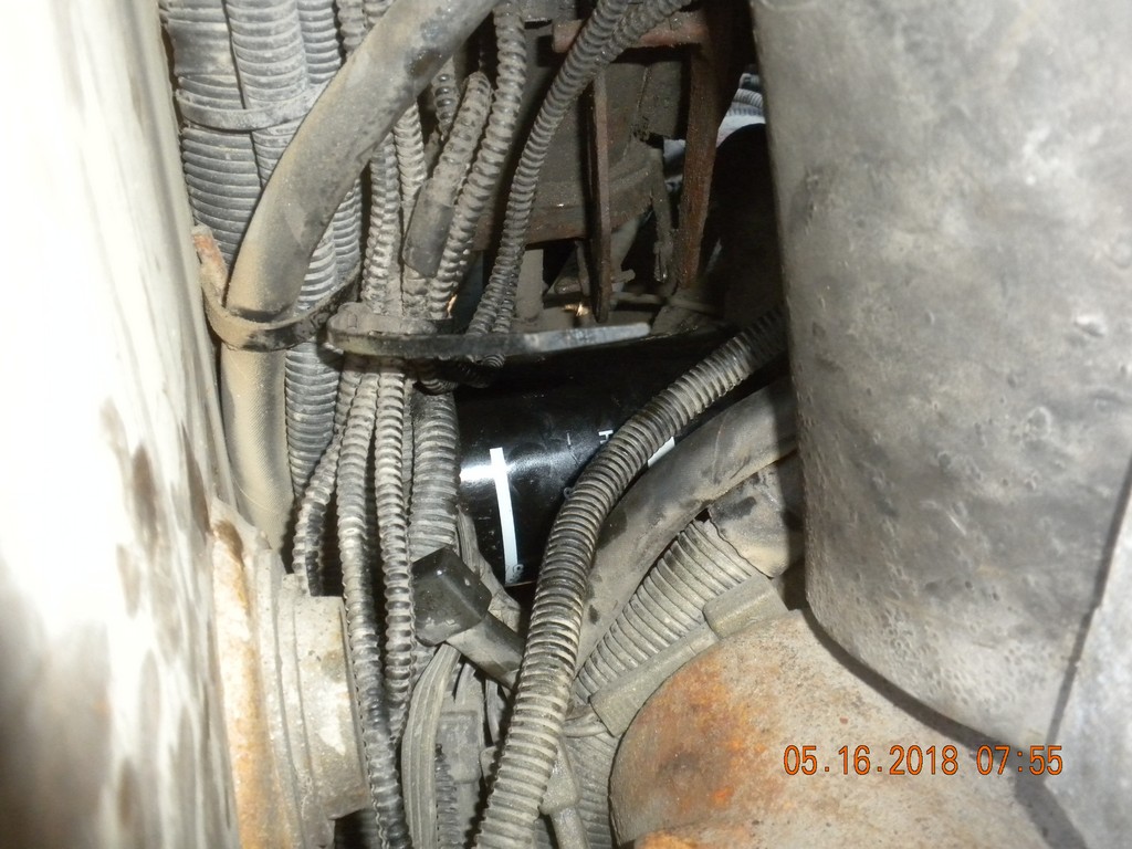

Put the new one in with the closed end first.....the reverse of taking the old one out.....wiggle it around and you can get it lined up to screw in......a flashlight helps to see where you need to go.....
You have to do most of this by feel, cause it's awkward looking and installing at the same time.
Once I got the new one bottomed, I used that filter wrench to turn it a 1/2 turn and voila':
