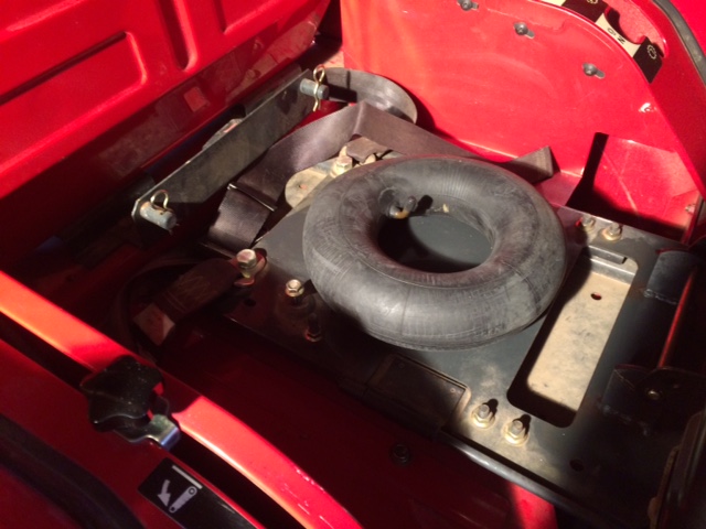

Well perhaps that is stretching it a bit but here's my story:
The seat cushioning on my Mahindra is very similar to that found on many CUT's. A hinge on the front with two compression springs near the back of the seat bottom....
I noticed the "ride" as being very stiff so did some calculations on the spring rate with the being made of 6mm wire wrapped with about 5.5 active coils and 1.5" spring inside diameter.
My results show a spring rate of 165 lbs/inch of compression times two springs. ( At least 330 lbs to deflect the seat down 1" and that doesn't even take into consideration that the hinge is absorbing 1/2 of the load) The problem is that I only weigh about 190 lbs so it's about riding in a lumber wagon going down a less than smooth road.
I do agree that "air suspension" in the thread title may be stretching (or perhaps compressing) things a bit, but doggone it, the 2.80 x 2.50-4 inner tube is rather cushy.
Now I'm not planning on adding a 12VDC compressor or anything silly like that, but adaptive ride control would not be totally out of the question. :)

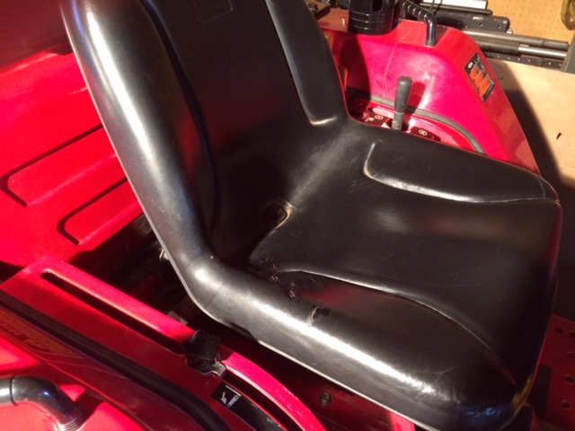

I occurs to me, after further thought, that someone might conclude that I simply removed the tractor seat and replaced it with "the cushion". Be assured that is not the case as it might be rather uncomfortable given the valve stem position. :eek:
In the interest of full disclosure, the seat is simply folded forward out of the photo and will be used in it's normal position during tractor operation.:dance1:

Npalen. Are you still the front "hinge" part and using the tube in place of the springs?
   / Converted Tractor Seat To Air Suspension--pics
#9
Yes, the front hinge is intact. I just removed the two springs at the rear and replaced with the inner tube.
This whole thing probably seems a bit crazy but it sure beats the "lumber wagon ride".

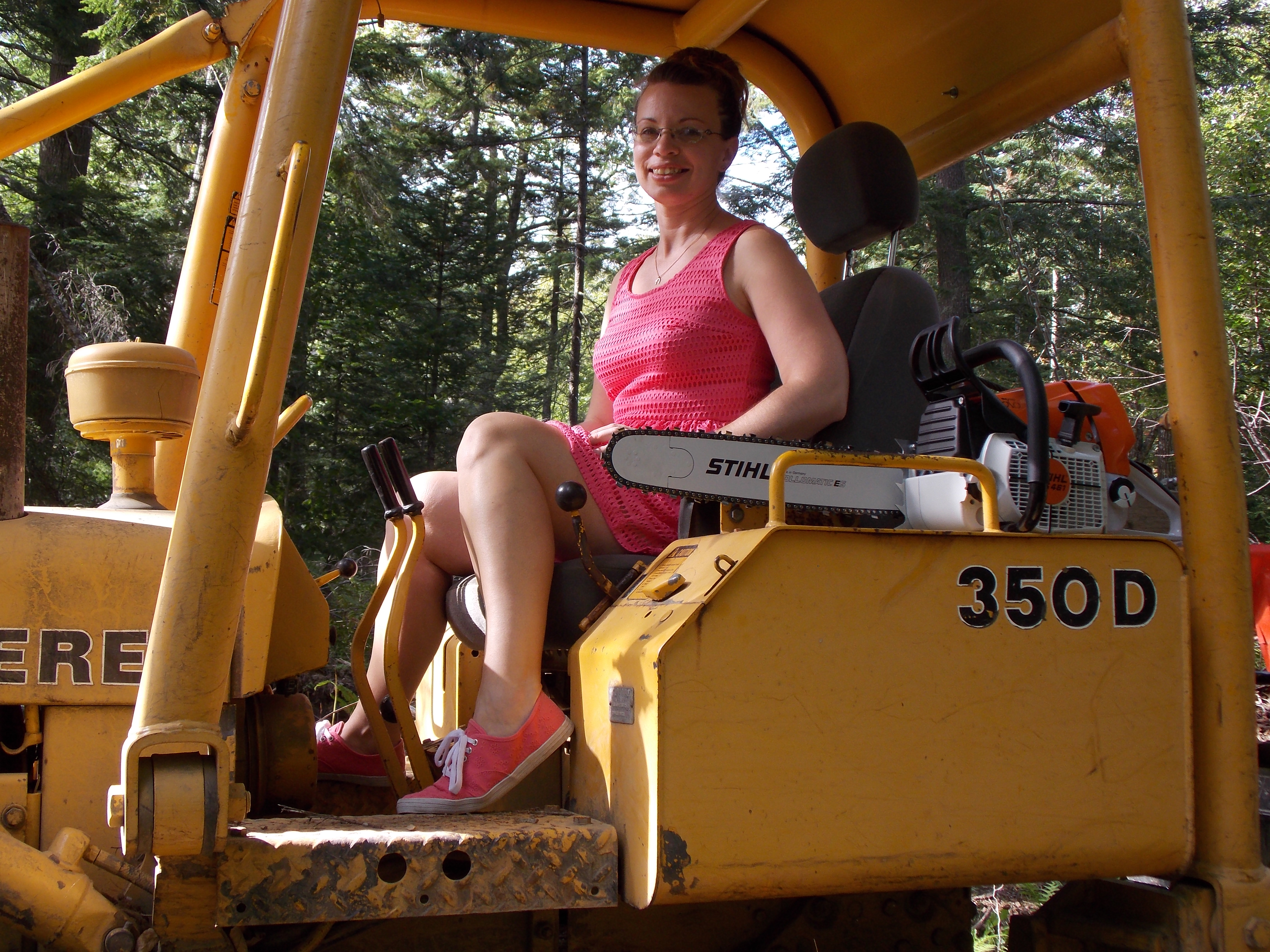

Another thing people can do for a much better ride is swap out the cheap Original Equipment Manufactuer's seat with one from a car. I happened to have a Ford Focus going for scrap metal, so I robbed the seat out of that for my Bulldozer. Some people do not like the look, but they don't ride in it either!
Just a difference approach to the same problem.
