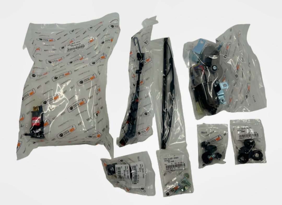

The kit itself looks something like this:

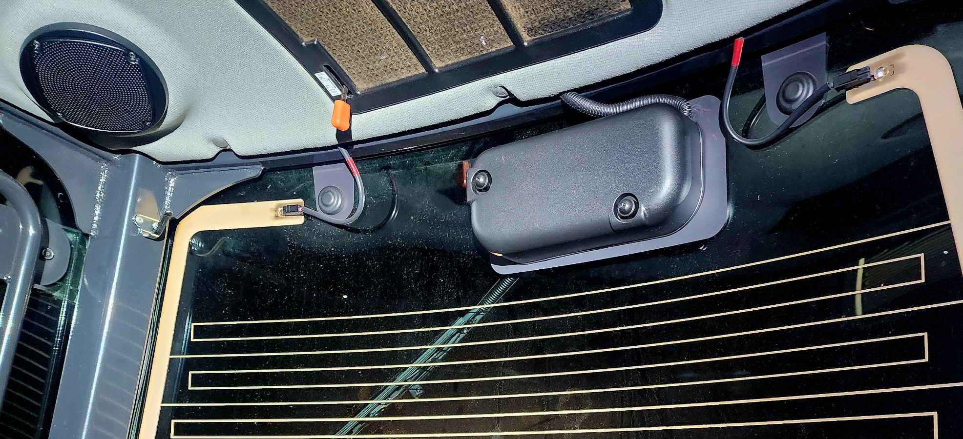

Basically, the OEM washer tube goes through a grommet in the window, wiper motor post goes through the larger grommet in the window and then 2 Cushion bolts are inserted from the outside of the window, through the glass and into the mounting brackets on the motor.
Mounting the motor to the inside of the rear window was where I called my wife for an extra set of hands as I needed her to hold the motor from the inside while I slid bolts through the outside glass into her and then she held the rubber washers and got the nuts started from the inside.
Once the motor was mounted, she was able to take a break. The majority of steps following that can be done with one set of hands ... the provided cover goes over the motor without issue, just need to route the wire loom and washer tube through the provided cutout on the cover.

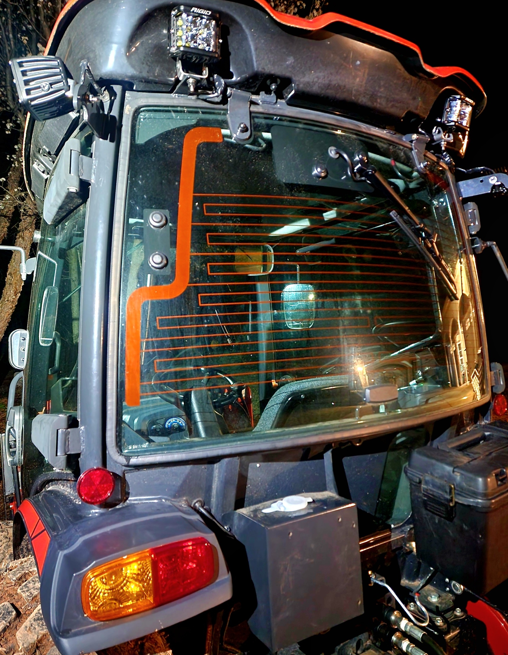

The wash tubing exiting the cab connects to the wiper arm, it was at this point I had a look at the front wiper and saw that they routed the wash tubing through the spring in the wiper arm and I did the same for the rear... no mention of that in the instructions, but it serves to hold the wash tube in place until it reaches a tube mount clamp closer to the wiper connection point.
The kit comes with a new & larger wash fluid tank reservoir with 2 wash pump motors installed. Remove the 3 bolts holding the metal cover, disconnect the front windshield OEM plug and wash hose, slide the OEM tank up and off, replace with new tank, replace the front windshield washer plug connector & wash tube, then bend open the metal wire holders that are holding the factory provided rear washer plug connector and wash tubing, trim tubing and attach ... done, replace metal cover.

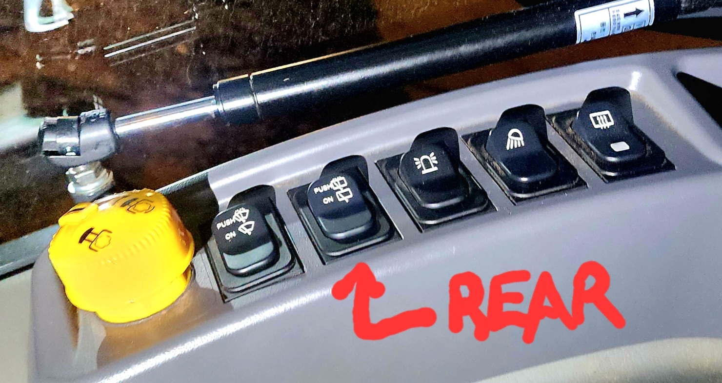

The 3-position wiper/washer switch is also included in the kit, just need to unscrew the 3 phillips head screws on the fender cover, snip the zip tie on the factory harness and pull the OEM wiper/washer plug up to connect to the provided switch that you mount in one of the available blanks.
As seen below, I moved my front windshield wash/wiper switch to the forward most blank and then added the new rear wash/wiper switch behind it (interchangeable positions of course, but I wanted mine this way as I had already used one of the aft blanks for my side lights using the "beacon" switch.)

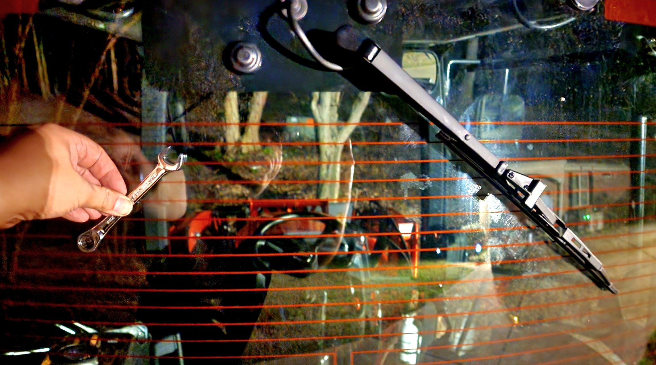

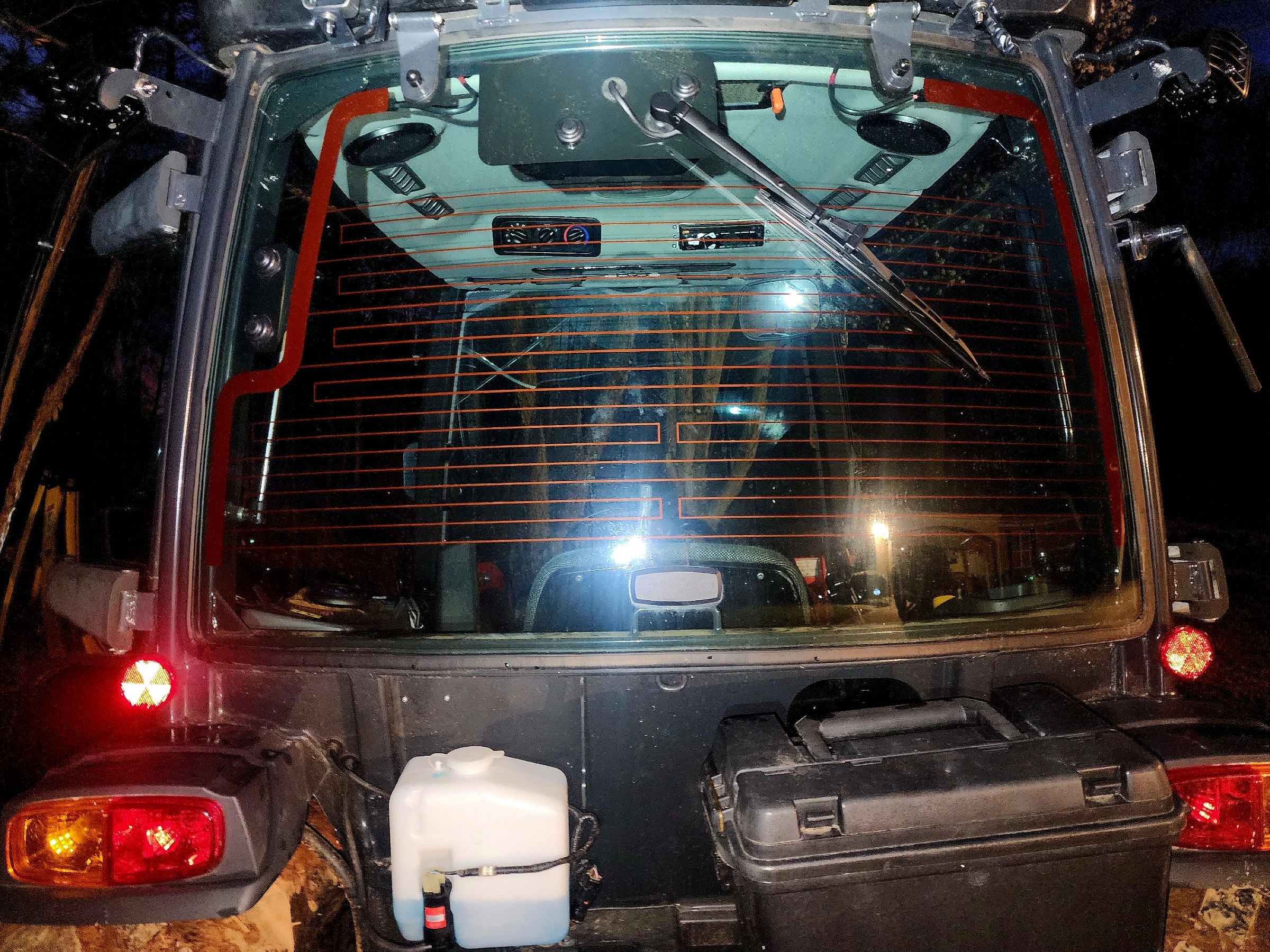

After fully installing & ops checking, the only complaint I have is that the "wiper arc" coverage on the rear window is much more limited than the wiper arc on the front. In the below pic, the wrench in my left hand marks the edge of the wiper arc.
Not sure if this is adjustable in any way, and while it looks pretty wide from the outside view, it's much more limited from the inside....
I also noticed that one of the 2 sprayer nozzles on the rear wiper arm is way off and is spraying away from the window; Again, not sure if that's something I can adjust, but will dig into it further as I ran out of daylight this evening...
