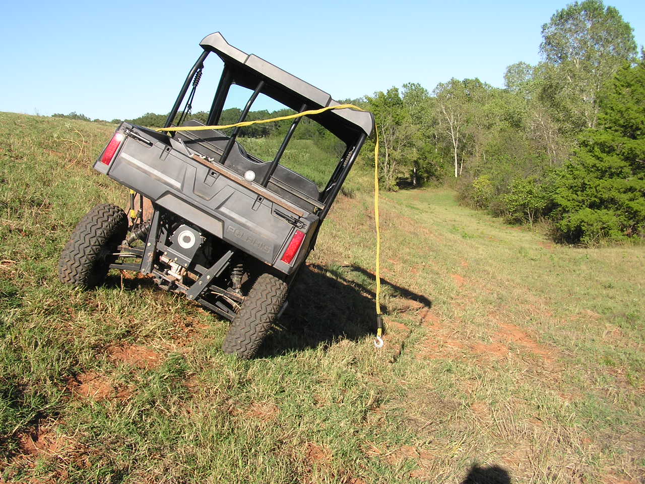

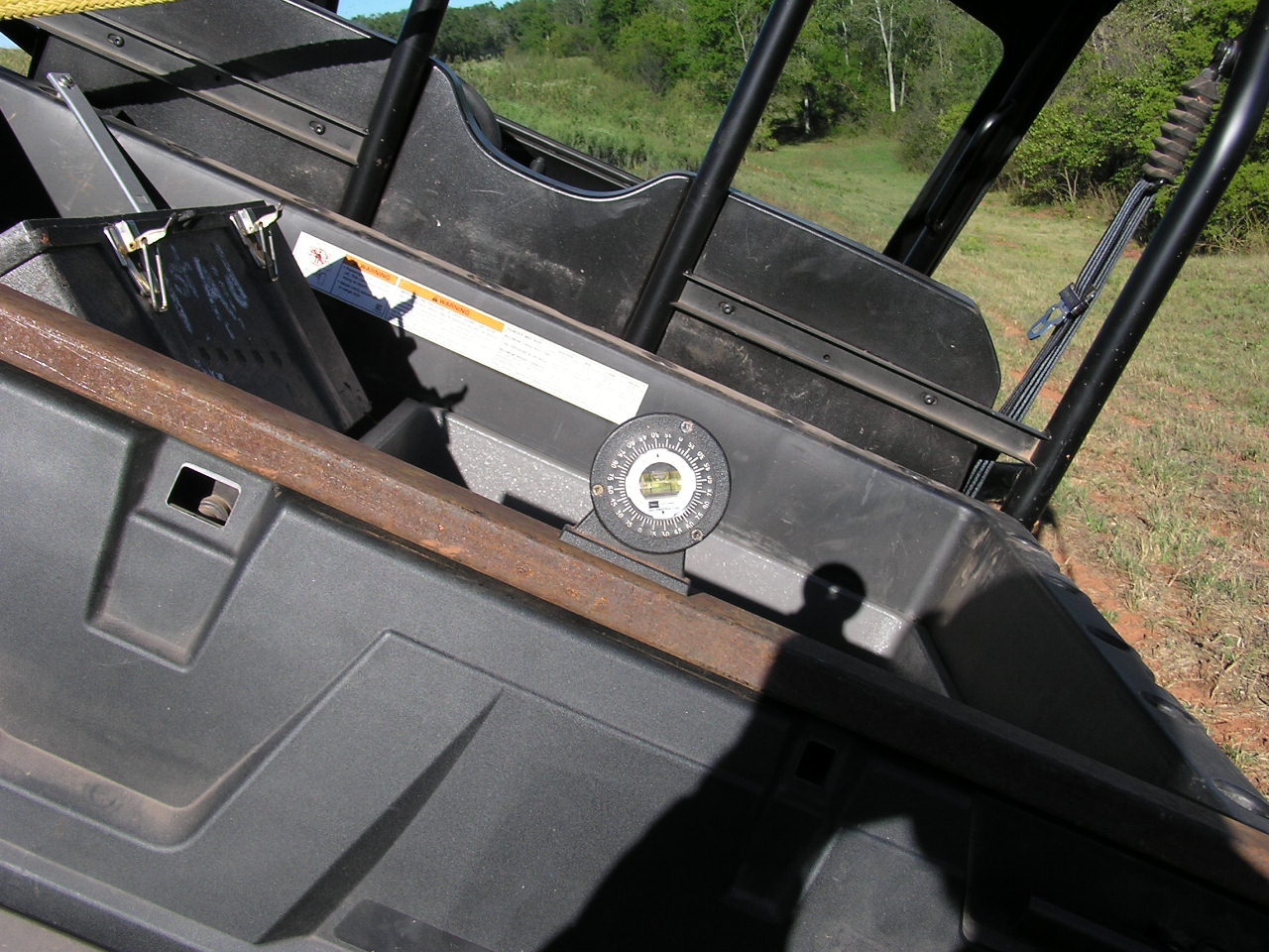

How are you measuring the slope?
A 10% slope is only 5.7 degrees, 15% is 8.5 degrees, no pucker factor at all.
This is what 30 degrees of body lean looks like on a 50% slope
More info on slope: http://www.tractorbynet.com/forums/toolcat/69420-slope-ability-bobcat-toolcat-5600-a.html
