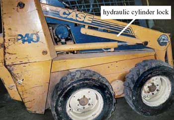

Would like to make something for the B26 loader. Anyone make a loader cylinder prop? Prefer something attached and quick to deploy/store like on the M59. Brainstorming for ideas.
   / FEL loader safety prop #2
Why not just copy the design of the M59 lock, and size it to fit the B?

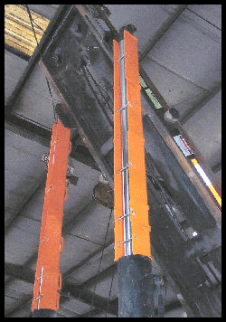

Use an L or U shaped block on the cylinder rod.

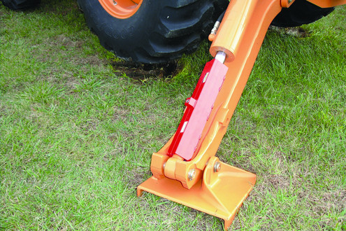

That prop on the backhoe stabilizer cylinder rod for leak down or antitheft?
   / FEL loader safety prop #7
That was just the first photo I found to illustrate the concept. Imagine a longer one placed on a loader cylinder rod when in the up position.
Some more:
