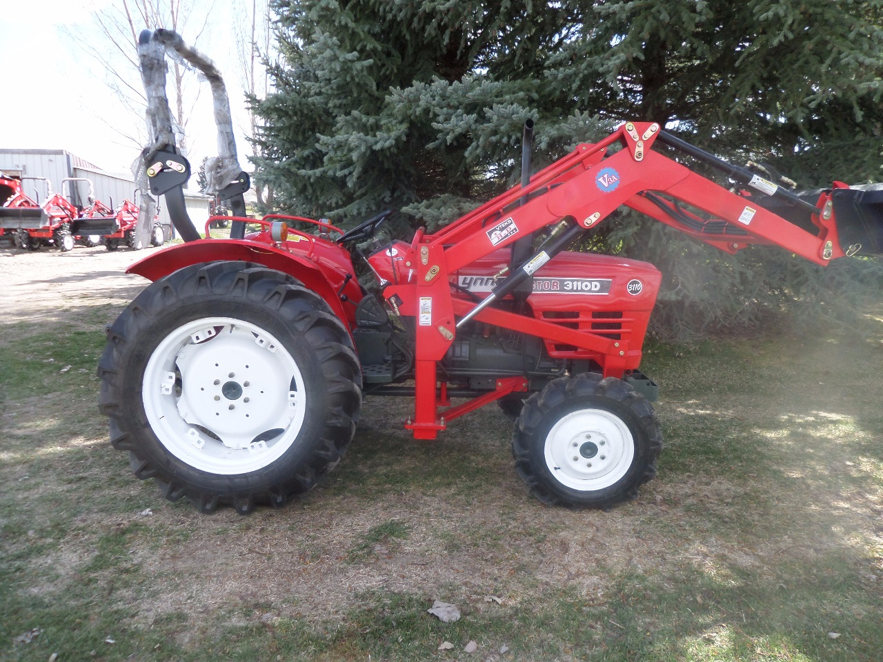

I would like to drain the hydraulic fluid from my Yanmar 3110D and refill it with a better hydraulic fluid for cold weather than what the rebuilder used. Also the fluid that is in it now has been heavily used over the last four or five years and I should be replacing it anyway.
How do I go about doing this?
By that I mean, where is the transmission drain plug?
How many gallons of hydraulic fluid should I have on hand for the replacement?
How many five gallon buckets should I have to drain it into?
The tractor has a loader frame and power steering run off the hydraulics as well.
Once I get it refilled do I need to bleed it somehow to get it back working?
Picture attached for reference. It was taken at the rebuilder's place before I took all the wrapping off the ROPS etc.

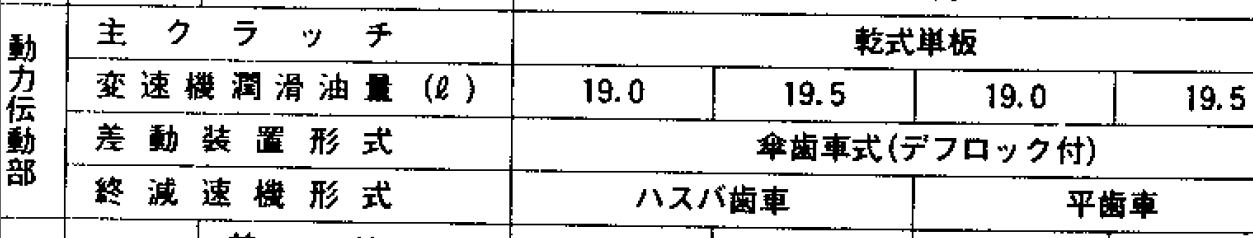

A3 - As Winston pointed out, the YM3110 is much 'like' the YM336. So, look for the
YANMAR YM336 PARTS MANUAL Y00T2140.pdf in that linky. It covers the same 3T84A-N engine. However, the manual does not have a spec and summary page like the Gray Market manuals do, so looking at the very next YM model is the YM2420.
Cut-n-paste into Yandex OCR Japanese to English get you:
So, about 19 to 19.5 liters.
