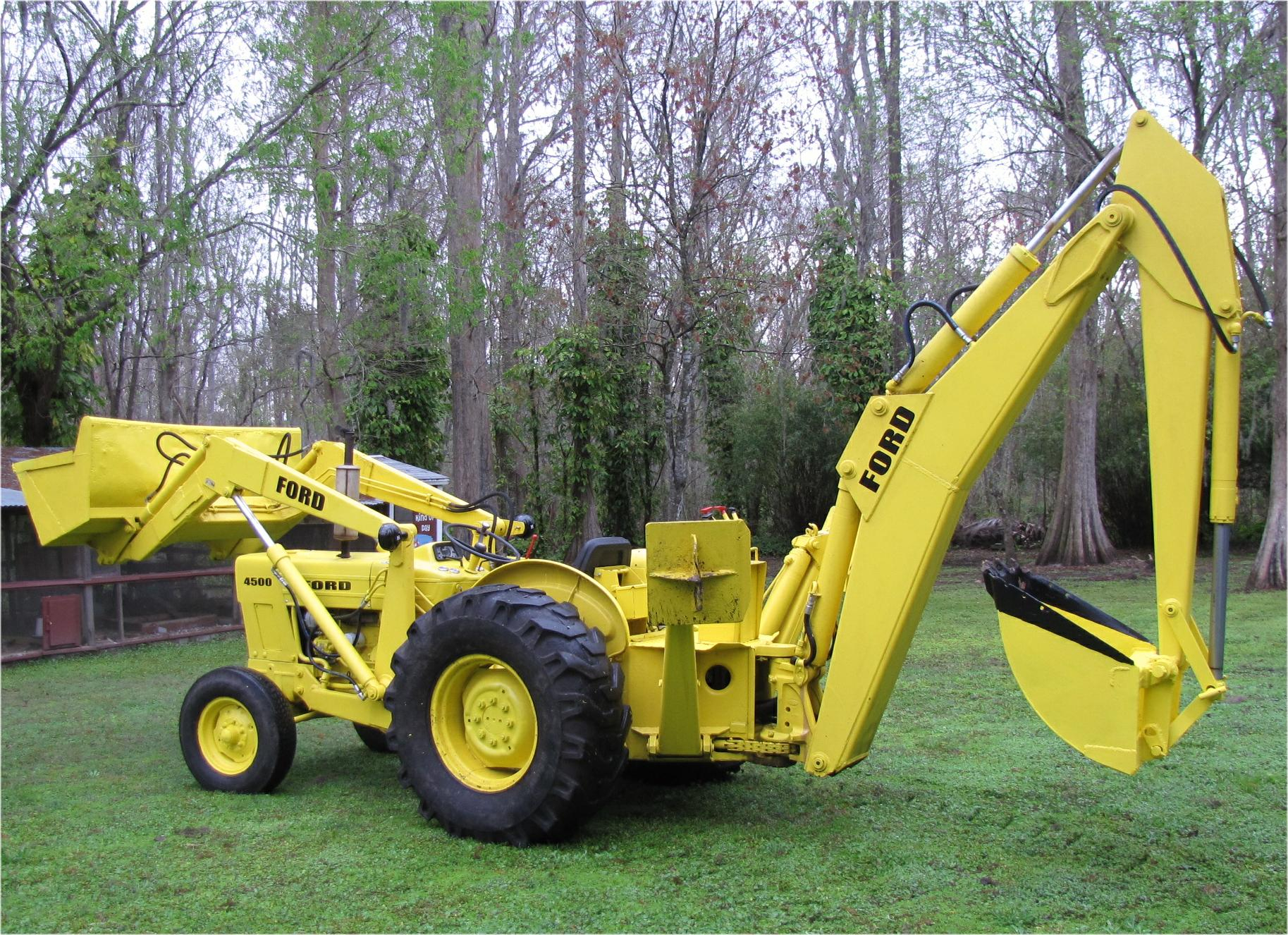

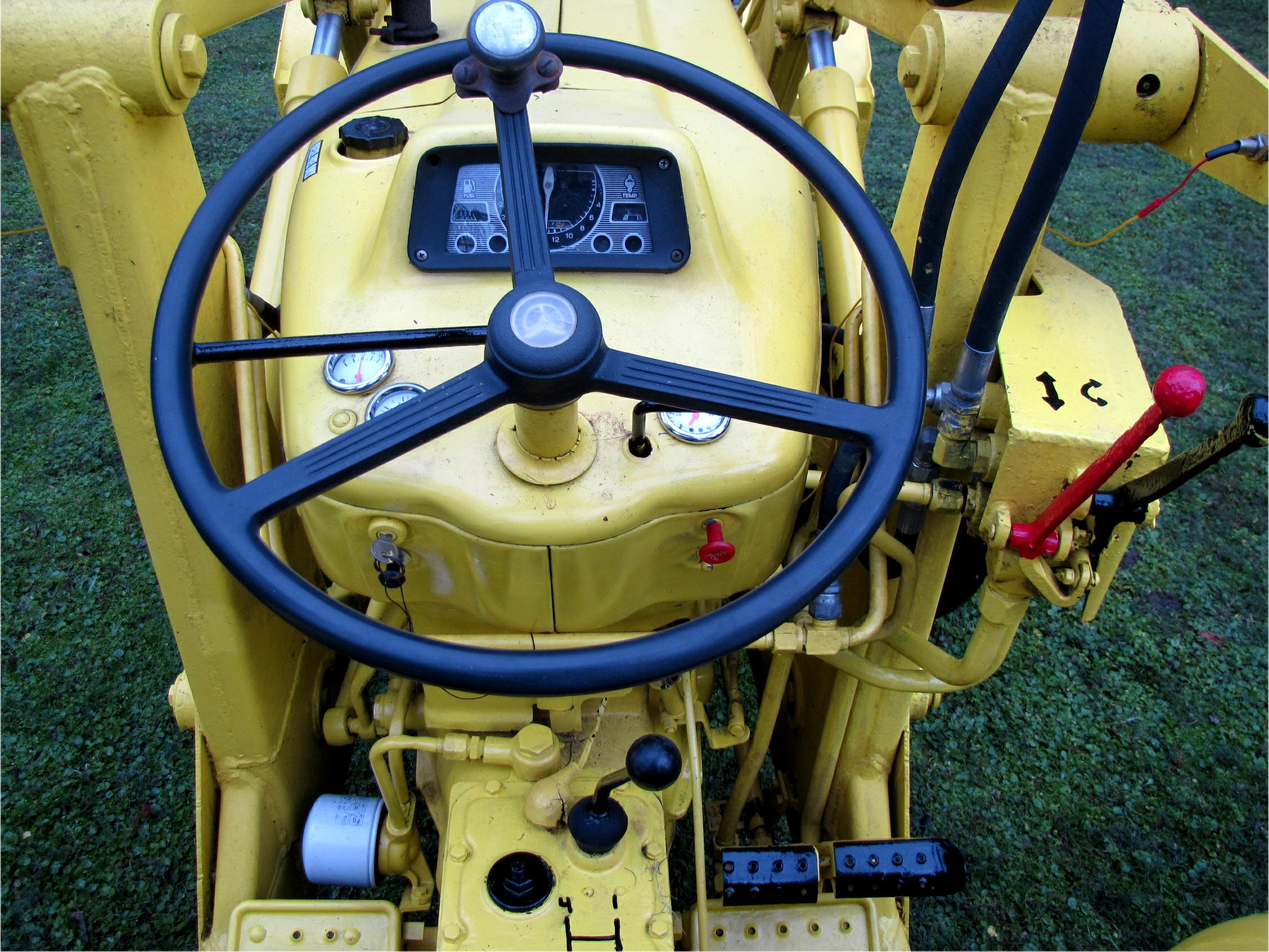

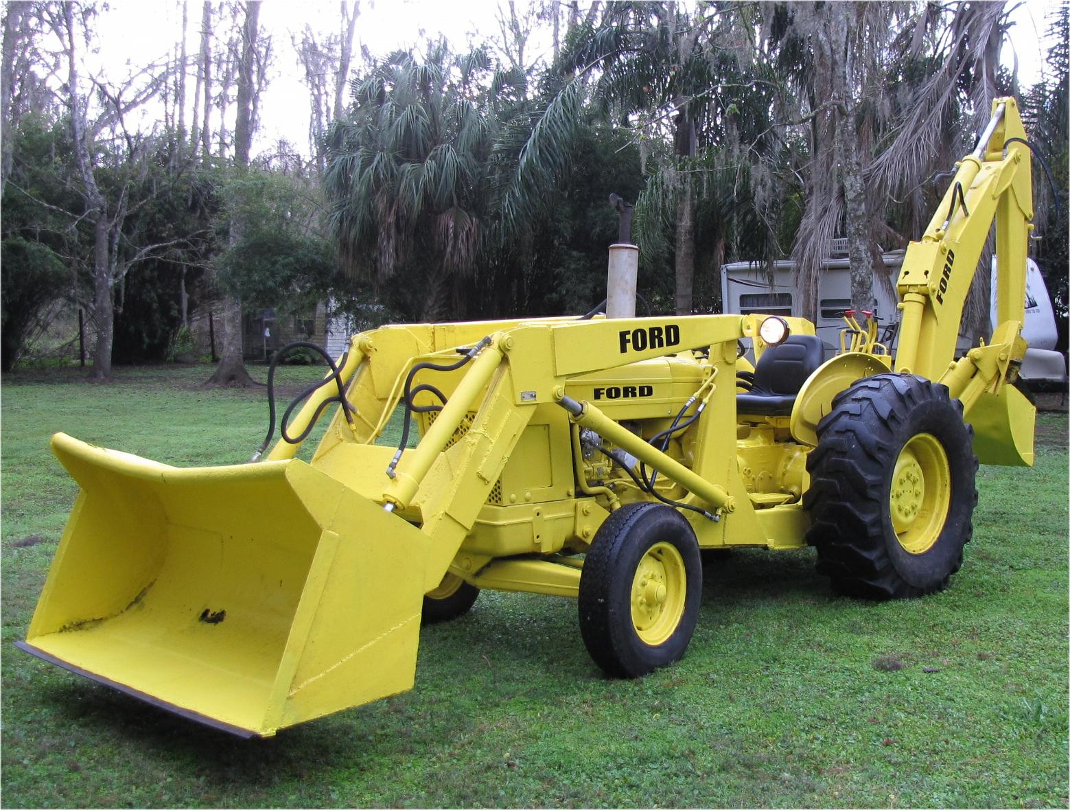

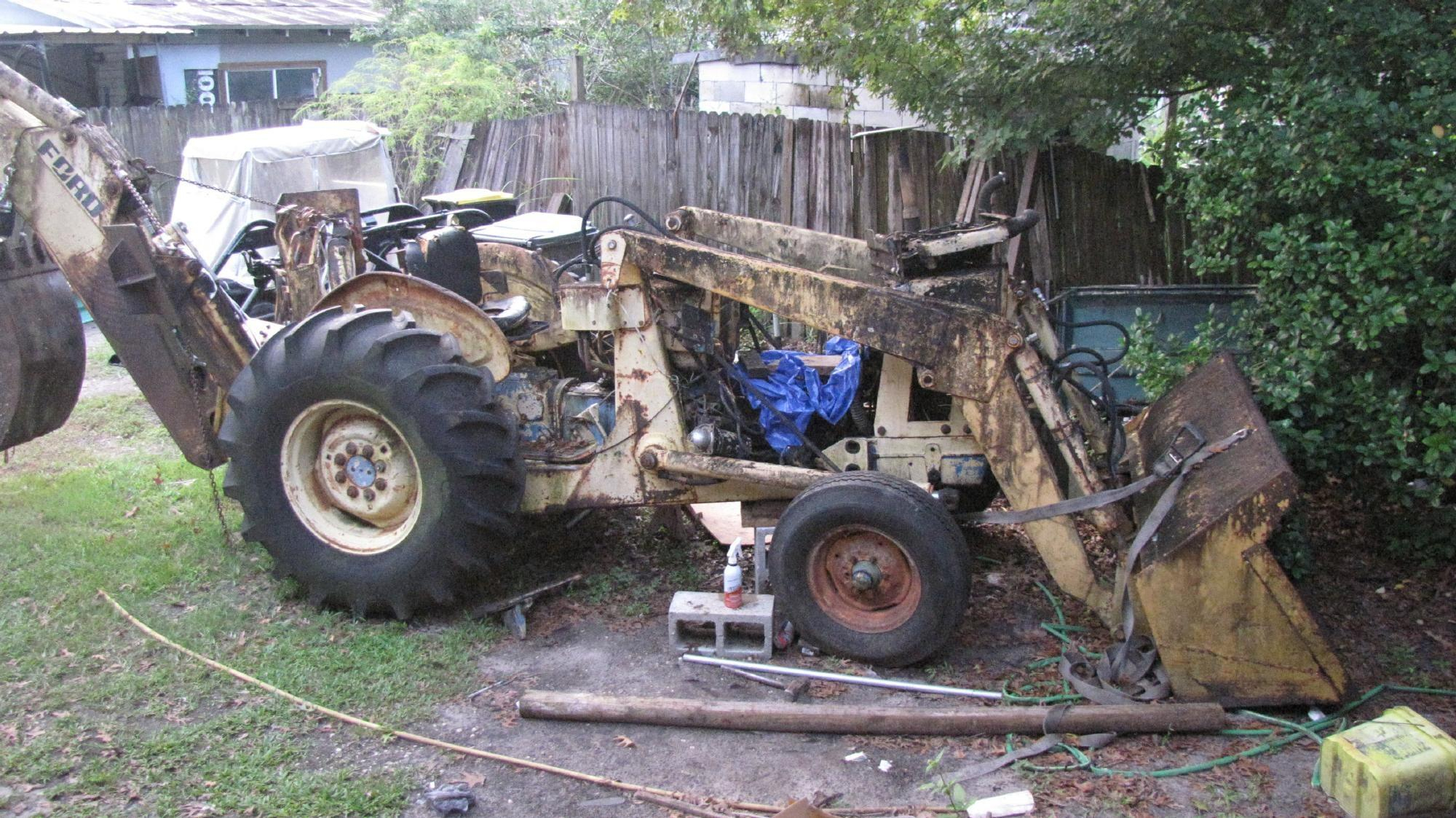

Here's a few more pics. I've rebuilt a few tractors. I included a before pis too

Nice paint job! Nicer than factory
