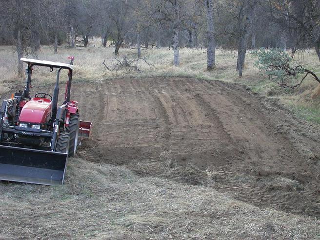

This attachment shows one of the areas I selected for a small plot near our campsite. It was taken around Thanksgiving 3 weeks ago. This plot is part of a meadow that has a game trail running through it.
I'll check the progress next visit up. We've had plenty of rain since then so I've been lucky with watering so far. I've got plans to do 2 more plots in the spring.
Any suggestions from you guys?

Thanks for the informative post. My plot is not doing as well as I hoped. After preparing it and seeding with the same Whitetail Institute Clover as you, I still see natural grasses coming up and very little clover. My weather here in CA is not freezing cold but once in a blue moon so I thought I could start seeding in January. I guess that's a mistake.
Would you recommend overseeding now to help it along? Or do you think I should plow it up again? Then seed? I hate to wait for August to establsh the clover unless it's absolutly madatory. I also like the turnips you planted. Could I plant some now as well? Any suggestions would help.

I don't know what your ground temperatures are running in your area so I can't say whether you can frost seed now or not. I've been told that you can frost seed on top of the last snow and that when the ground warms, it will germinate and there you go so I would frost seed when air temperatures still are hitting freezing.
If you have problems with grass now you have 2 choices. A. -wait till the grass starts growing well and treat it with a clover compatible liquid that Whitetail Institutes sell (slay or arrest I don't remember which is for grass and the other is for broadleaf weeds) or B. - Till everything by discing or rototilling repeatedly until the grass and the buried seeds are killed off.
I'd do the frost seeding now and see what happens. As I recall, your plot is pretty small so you don't have a lot at risk so give it a shot. Worst thing that could happen is you have to wait until late summer/early fall and do it again.
