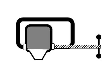

I've attempted to draw a diagram below of 1/2 of a tire cross-section on a rim. The gray part is the tire and the white part the rim. I placed my 12" C-clamp over the tire as show and clamped down on the bead. I had to do a little "convincing" on the bead on each side of the clamp with a big flat-blade screwdriver, but with a little work the tire popped off the bead and then I let the C-clamp catch the rim on the front and pulled the backside bead off the rim as well.
Putting the new tires on is the hardest part. The back bead easily goes on, especially with soap. When you get to fighting with the outside bead to get it on the rim, things get interesting. Several flat tools to pry and hold are necessary and a hammer to tap (whack) the bead is needed. I've changed enough tires that I know the routine. A couple of extra hands from a helper is also good. My grandson helped me and we got 'er done.:thumbsup:
BTW: If the tires are really stuck on the rim, you can cut them off through the sidewall and then work on getting the rest off. After all, if they are going into the trash, you don't need to be too "friendly" with them. Putting the new tires on is different. You have to be careful not to cut the bead and once the tires are on the rim, you may have to put a ratchet strap around the middle and pull it tight to cause the beads to expand and inflate. Make sure you remove the valve core for maximum airflow from your compressor. Some would say that you can use ether or cigarette lighter fluid and light it with a match to set the bead, but I'd rather watch that on U-tube video than actually attempt it myself.:shocked:
