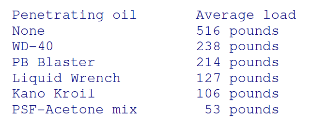

Appreciate your recommendation of PBlaster as well. I've gone through a few dozen cans of that in life but I'll share I've since moved on to a cheaper and more effective penetrant... a 50/50 mix of acetone and power steering fluid, reported in Machinist's Workshop in 2007. My native impatience usually adds oxygen and acetylene to the mixture post application to just part of the circumference of the outer perimeter to further enlist the assistance of physics. Final detail on that mixture.. the original article calls out ATF but the tester actually used power steering fluid (as reported elsewhere on the internet). I have had unusually good luck freeing up crevice and dissimilar metal corrosion in a marine environment (without fire) with that solution.

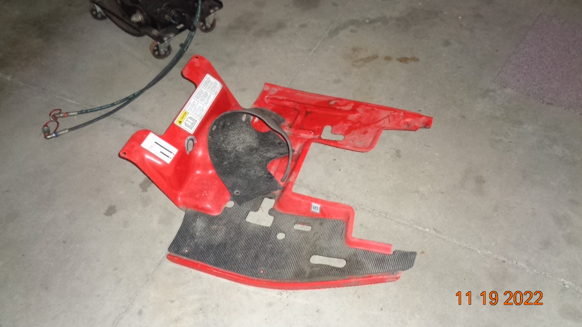

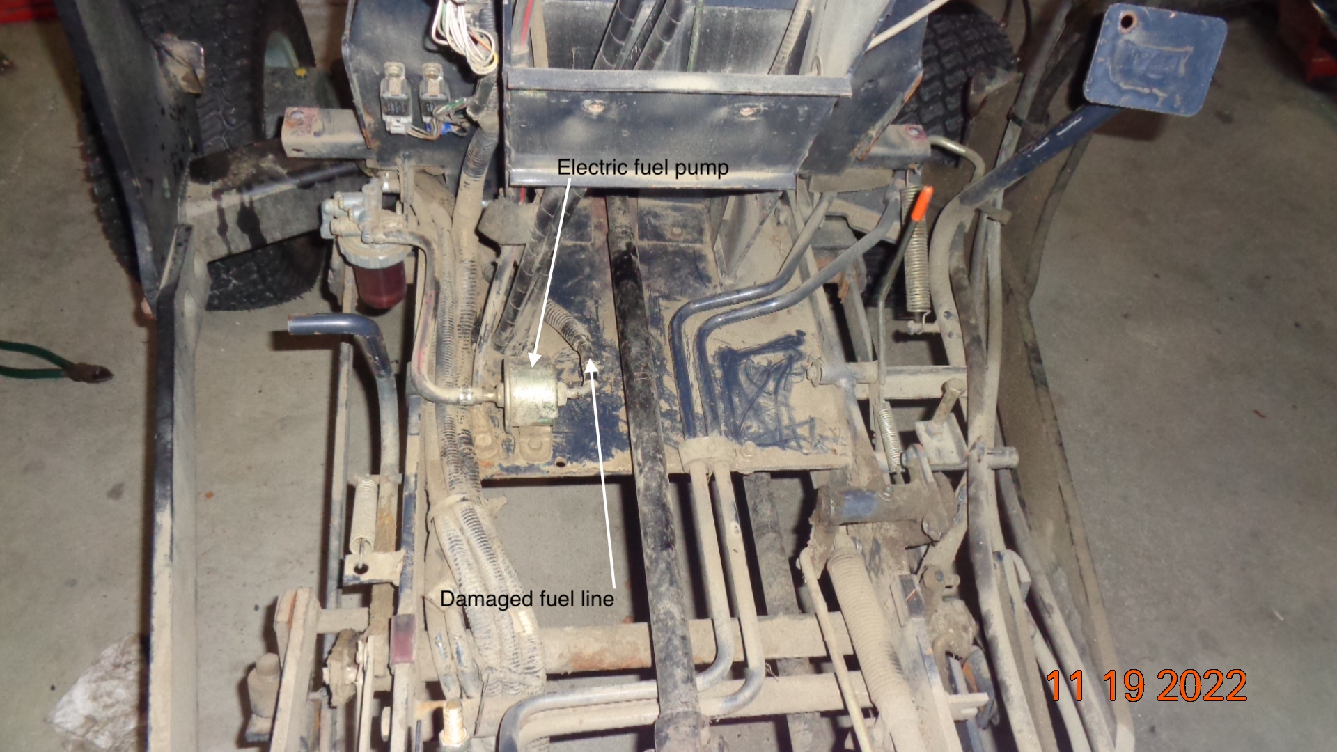

As an aside, I recently had to replace the fuel line that goes from the injection pump on the engine back to the (very) small electric fuel pump under the floor. In doing so, I removed the entire floor panel, which wasn't as bad as it sounds, actually. Removing the entire floor will give MUCH better access to all that stuff under there -- the HST driveshaft, the plastic fan, and all the debris that piles up in there.
Begin by removing the panels around the air intake under/around the instrument panel (as above), but then pop off the rubber floor mats (held in with plastic push-button things). Then remove the knobs that need to come off-- some just pull off, others are threaded. Once the rubber mats are off, you can see where the floor metal has enlarged holes so it can fit over stuff like the brake pedal and the diff lock. The floor panel itself is held in with a bunch of bolts...maybe 10 or so.
PS-- there's also a ground wire -- the one that comes right off the battery negative post!-- right next to the fuel pump that you'll probably want to clean up...
