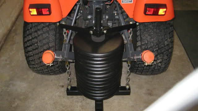

its not gonna happen this winter but for next winter I would like to have a 350-500lb or so rear 3pt (class 1) weight bucket that ALSO has 2' reese hitch capabilities.
I don't have a welder so cannot build myself, also due to fibromyalgia (parkinsons like shakes) I can't borrow friends/familys welders to build myself. I can't weld a straight bead to save anyones life...irony is the shakes work GREAT when brazing LOL
so I was wondering if any GC series owners (larger tractor owners prob not gonna have same needs as scut owners) had come across anything that meets these needs.

I bought a commercial three point ballast box. It already had a two inch receiver attached. It even came with the retaining pin.

Paid $255 with a coupon I found online.

After buying/building your ballast box, a wooden stand keeps it from dumping over when you back into it

I built a ballast box for my tractor. This barrel is over 860 lbs with 14 bags of kwik crete in it. If you built it with half the bags, you'd be at the weight you're looking for. A receiver hitch could be installed in the barrel also, concrete would secure it.
