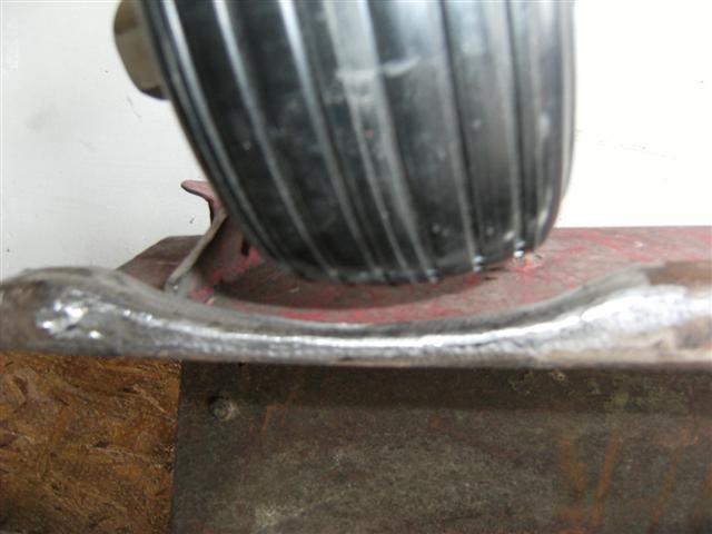

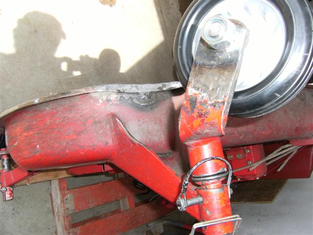

Expensive aren't they. I know the feeling and couldn't see myself paying that price for them,so I didn't. One other reason was that the shafts were worn as well so putting new wheels on would have be stupid. I ended up buying some different wheels with full length bearings inside,plus they are greaseable. I believe that they were $ 35. each.I had to replace the shafts so using a angle grinder I ground down the welds and was able to remove the old shafts.I used a long enough 3/4" bolt and nuts to hold the new wheels in place.Used the head of the bolt to keep the wheel from sliding off then put on a nut put the bolt through the bracket then a nut on the outside.At least by using a bolt for a shaft it would be a easy replacement if I ever needed to do it again.[In all fairness I did just sell the MF gc 2300] Just showing you what I did and it worked out fine for me for 3 yrs there still in great shape. I did have to modify the deck just a bit at the front so that the wheels wouldn't rub on the front.The wheels are 6" dia so now the deck won't cut lower then 2" in the lowest setting.It was good for me as I never cut my grass any shorter.Here's some pics of the deck mod. with the wheels on.If you interested in what wheels I used I'll see if I can hunt up the make etc:Just looked up te wheels. bought them from a place called Casterland [Martin wheels] item # MWZP625T 6.25x3" HD RIB/white wheel 3/4" RBx3" [centered] 250 lb [toro] with taxes $ 33.24. each.
