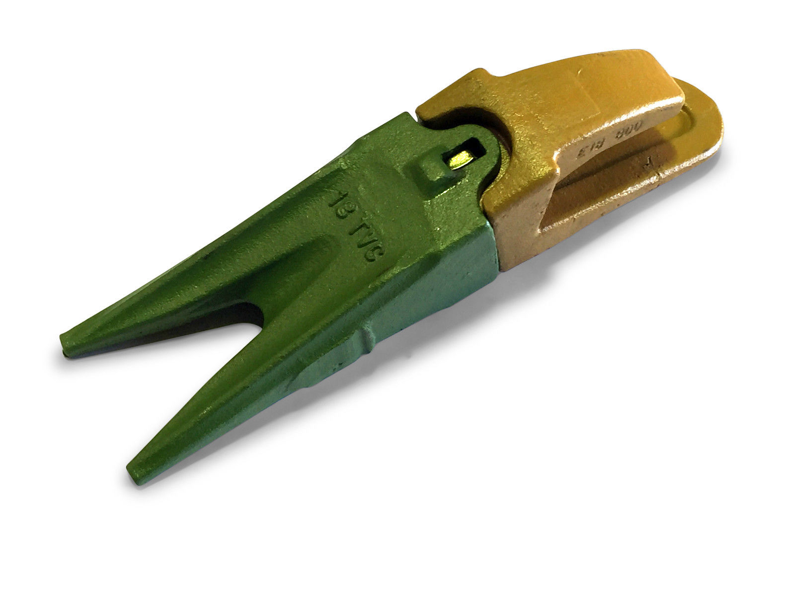

I would like to second OLDOAK in recommending Kubota's optional SSQA heavy-duty, round-back bucket for your granite conditions.
I had a standard bucket on my first Kubota. Nothing wrong with it but I had to baby it at times. The SSQA heavy-duty, round-bucket seems to be indestructible.
SSQA = Skid Steer Quick Attach = tractor industry standard fit.
Not quite ndestructible, but better than std. bucket.
I have about 100 Lbs of reinforcement welded and bolted on mine, sides & top plate, and bottom scraper. It has stood up well

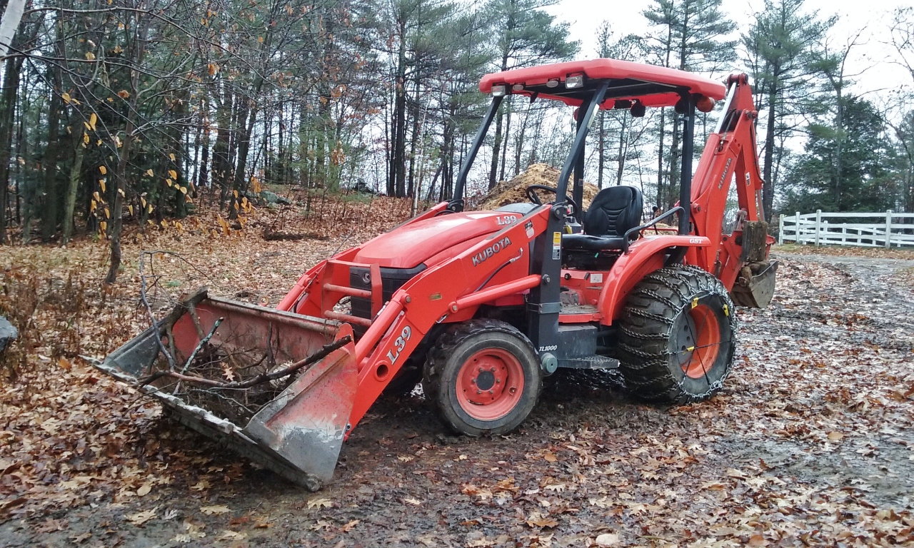

Hi all. So after my wife gave me a little matchbox tractor for Christmas and told me to go get a real one (I think she's calling my bluff about all the thing I tell her I'd do if I only had a bigger tractor), I've been busy reading up on tractors, attachment, and everything else. There's a ton of good advice here and I'm about ready to bite the bullet on a new Kubota.We have 15 acres in hilly Vermont with a small pond (hoping to make into a bigger one), long driveway, a nice little sugar bush for syrup, firewood, and lumber, a fair amount of field, and a lot of granite. With work and kids, I don't get as much time as I would like to play/work, but hit it pretty hard when I can.I am flipping between the L3901 and the L4701 to compliment the little JD GX335 we have. I'm planning on getting a loader, backhoe, tiller, box scraper, brush hog, and back blade. It's about $40k for the L3901 and $50k for the L4701.
Sounds to me like you would be better served with one of the Kubota TLB's. Add in the backhoe thumb and the 3 point kit and you'd be in great shape. Might as well take a look at the L39 and L45 before you decide. For safety, the TLBs feature a full surround ROPS.
BTW, it's a good idea to widen the stance with any tractor for even very modest hillside use.
Luck, rScotty
