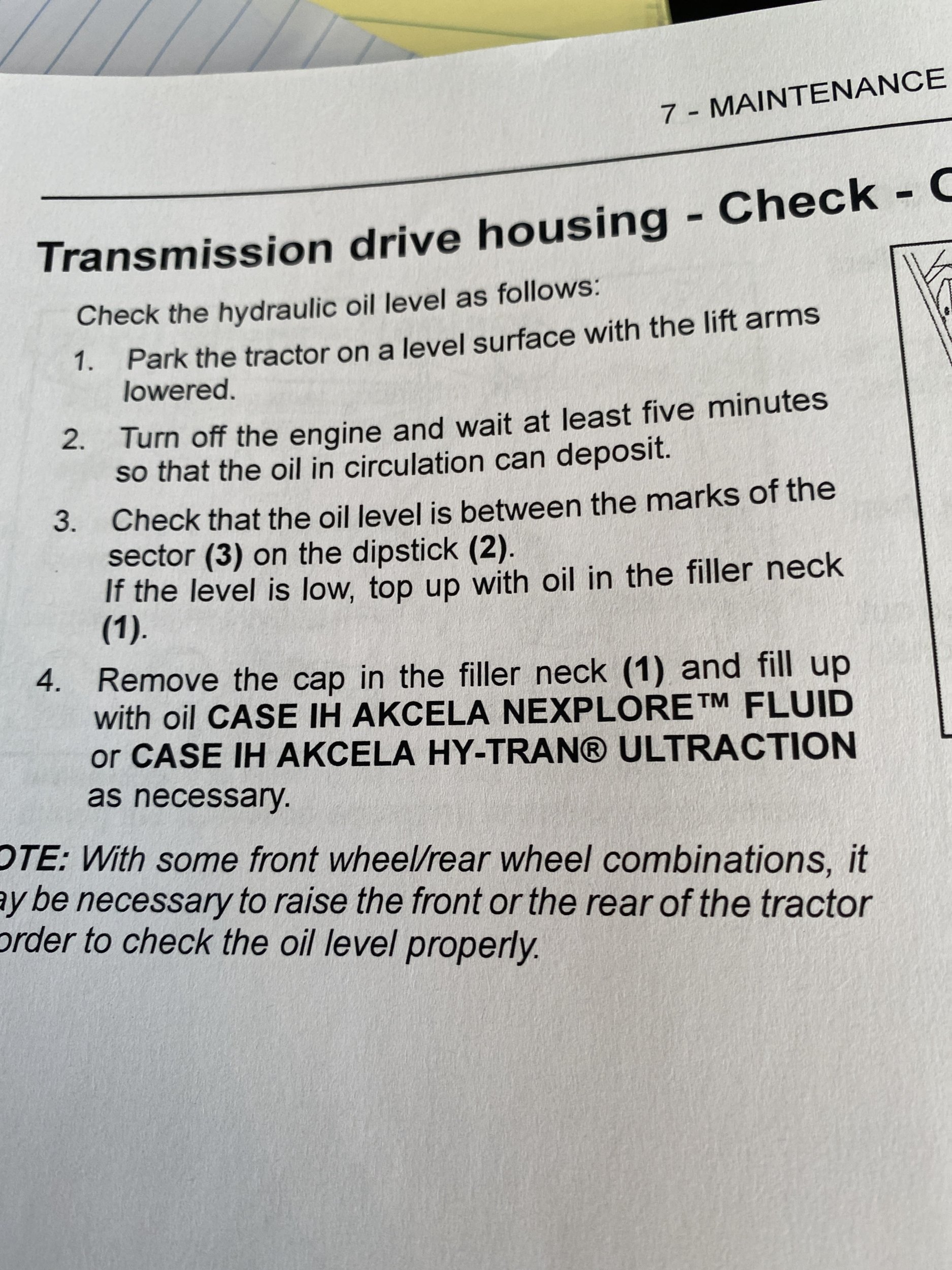

What spec Hy-Tran does your tractor call for;
they have made several different ones over the years.
The latest and greatest is;
HY-TRAN ULTRACTIONHYDRAULIC TRANSMISSION OIL MAT3540
Then you have ;
Hy-Tran plus from a few years ago
Personally I would be leery of the generic oils,
that said our IH dealer carries a Shell Hy-Tran which is what we normally use on the farm.
My choice is Cen-Pe-Co multi purpose fluid.
The Ultra Hy-Tran specs out much like a synthetic fluid of 10W-40.
Here is the spec directly from the manual.

On the jug of no name does it list any specs that it supposedly meets or exceeds;
such as HyTran Plus or JD D or C.
Either way 2 gallons wouldn't bother me a lot,
how long till your filter and fluid change?
With it holding 10 gallons the Genuine fluid is about $88 for a 5 gallon pail,
the others run $45 to $70 I would tend to go with the brand name or a high quality which will cost as much or more.

No farm rated stuff doesn't list any specs or anything on the bucket. The fluid has probably another year left of life.

Well it says that it meets current IH specs.
I wouldn't be pleased with that in my tractor.
I do change the filter and fluid a bit more often then required.
I don't know how often you need to top off from implement leaks and such,
if it bothers you change the filter and fluid early or just get better oil for any future top ups.

I think I will just change it out then sack punch him. Repairs are too expensive to risk it.
