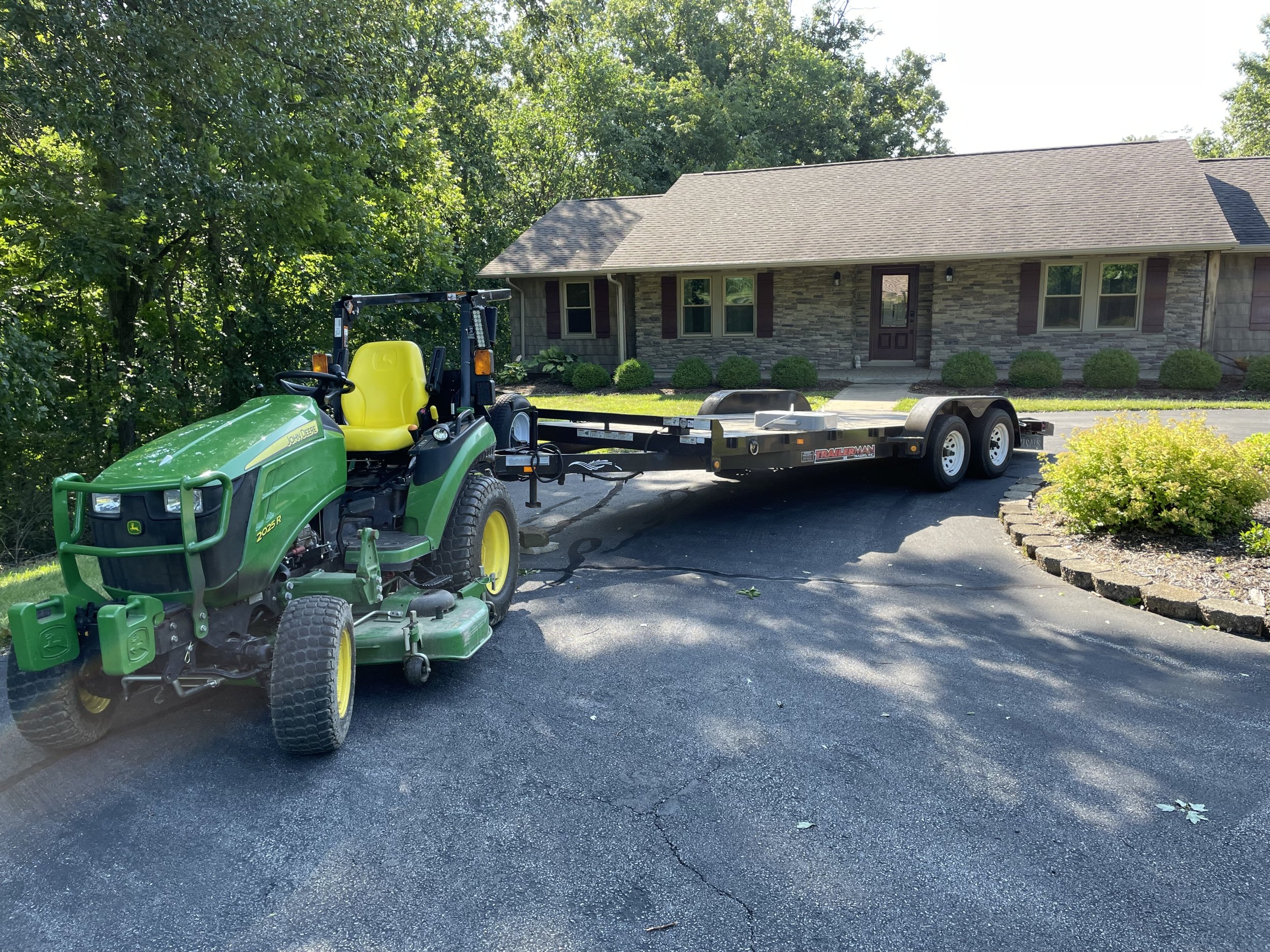

It’s been a while since the OP posted I assume he is still following. A picture of the front of my house, not the greatest but gives you the idea. Just a couple of ideas since your original post mentioned stone. The middle part is a cultured stone and we got lucky a found a couple of brick layers that did a good job. On each side shake looking vinyl siding, it adds a little texture. None of this added a huge cost. This was done on an external remodel.
If you are using the vinyl shakes I would use it in rectangular areas. The peaks on the end of our house are done it it and the angular areas seem to be more likely to lay flat.
Also our house is about a 1900 sf ranch, there is a little bit on the right side cut off in the picture plus an attached garage.
