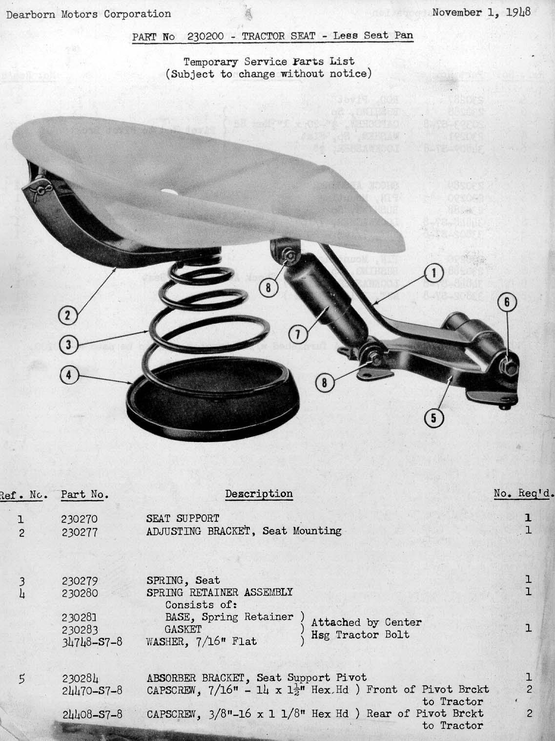

Nov 9, 2011 / help #1 S stan elliott New member Joined Dec 4, 2010 Messages 17 Location kck Tractor ford 8n 1948 Monroe EZ Ride Seat need to finded Parts for it Attachments 1948%20Nov%201%20-%20Temp%20Service%20Parts%20List.jpg 207.6 KB · Views: 111

Nov 9, 2011 / help Thread Starter #4 OP S stan elliott New member Joined Dec 4, 2010 Messages 17 Location kck Tractor ford 8n 1948 Bushing for #6 for rod
Nov 9, 2011 / help Thread Starter #5 OP S stan elliott New member Joined Dec 4, 2010 Messages 17 Location kck Tractor ford 8n 1948 i made a rod it i need Rubber bushing for rod
Nov 10, 2011 / help #6 Soundguy Old Timer Joined Mar 11, 2002 Messages 52,238 Location Central florida Tractor RK 55HC,ym1700, NH7610S, Ford 8N, 2N, NAA, 660, 850 x2, 541, 950, 941D, 951, 2000, 3000, 4000, 4600, 5000, 740, IH 'C' 'H', CUB, John Deere 'B', allis 'G', case VAC you might have to get creative with a piece of rad hose, split to correct id / od, or rubber mud flap or matting. soundguy

Nov 10, 2011 / help Thread Starter #7 OP S stan elliott New member Joined Dec 4, 2010 Messages 17 Location kck Tractor ford 8n 1948 thank you guys
