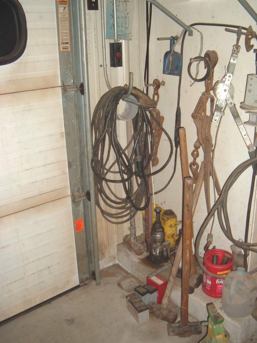

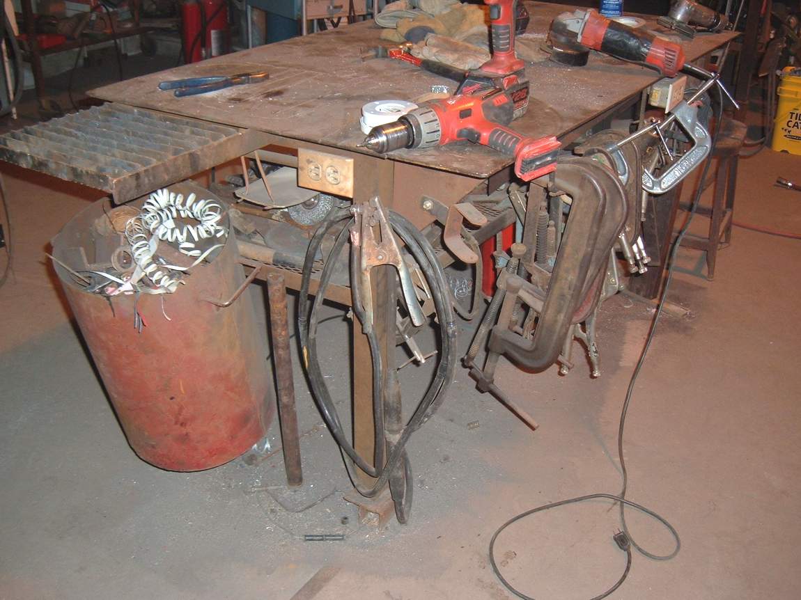

Go to the welding store after and buy some number 2 at least 15 longer than you think you need, 25 if you work outside, chop lead off a foot outside and splice it to the stinger and take the stinger lead and make a whip or splice it to the work lead.
