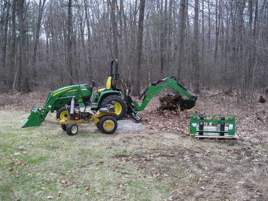

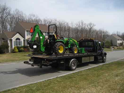

Well the tractor is back, new 448 installed. I was worried the hoe would be too big for the machine..but it is just perfect. Also had the mid pto installed, and rear SCV. The driver forgot the 448 manual, so before I go pick it up, if someone wants to run throught the connect/disconnect methods to the hoe, I would appreciate it. It ripped that dead stump up without even a wheeze. Somehow my little allis b12 snuck into the picture.

If you have not figured it out already. This is how I do it. Note differences in my method and JDs. Mine are in ()
Curl the bucket (Point the bucket, uncurl it all the way. Put a wood block under teeth)
(lower the stabilizers to just horizontal)
raise seat.
shut down tractor.
Remove BH hoses. Cap them.
Connect 3pt hose to power beyond.
start tractor
raise rock shaft control (3pt )
remove retaining pins from frame.
lower rock shaft untill bh is on ground
Drive away.
