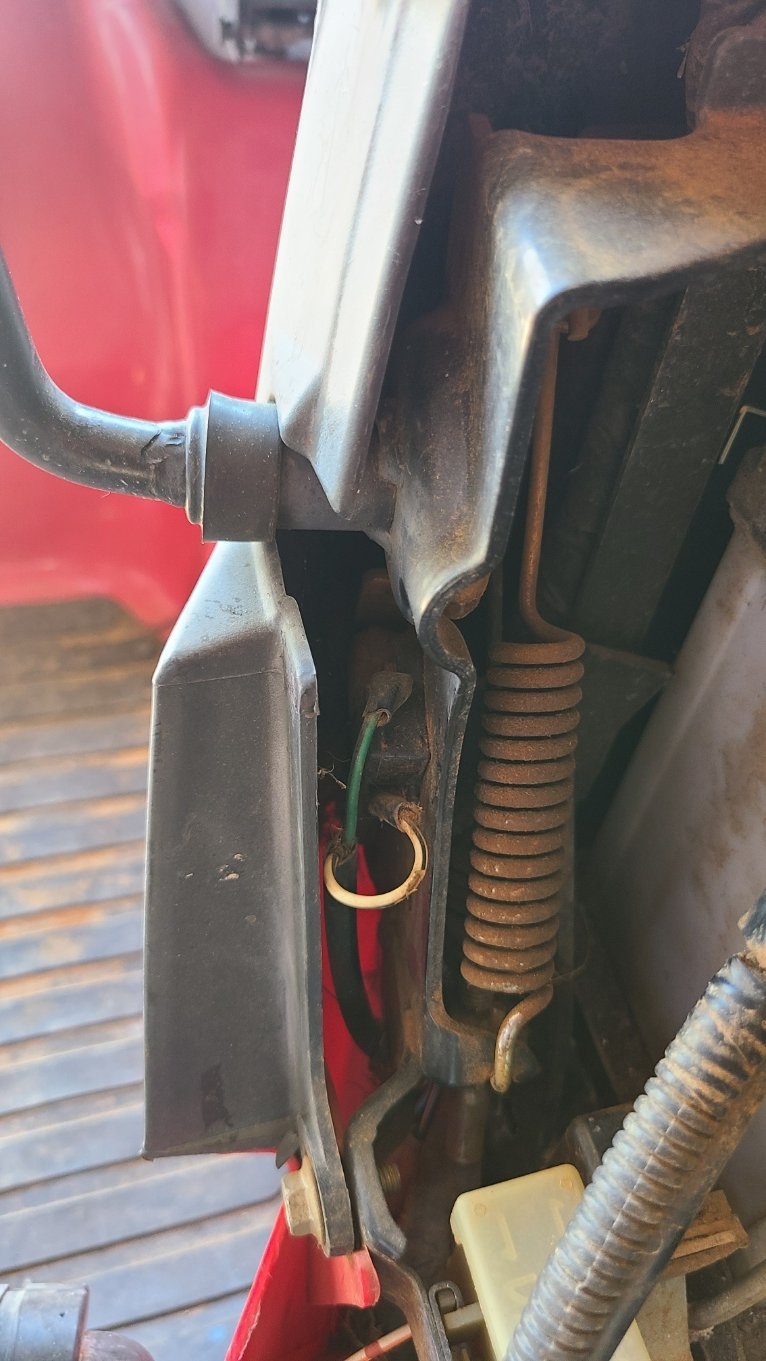

I just got this mower from local CR for a hot summer project and paid only $100
It runs very well and works well except the engine dies while PTO engaging in.
I suspect that the PTO switch is bad in the last picture.
Also, the prior owner replaced the parking brake cable about 1 year ago but not working properly
I have very much experience with other riding mowers but this honda.
It is the first time in my life.
Any members here have any suggestions, would be much appreciated.
Thanks in advance ..
Jkk

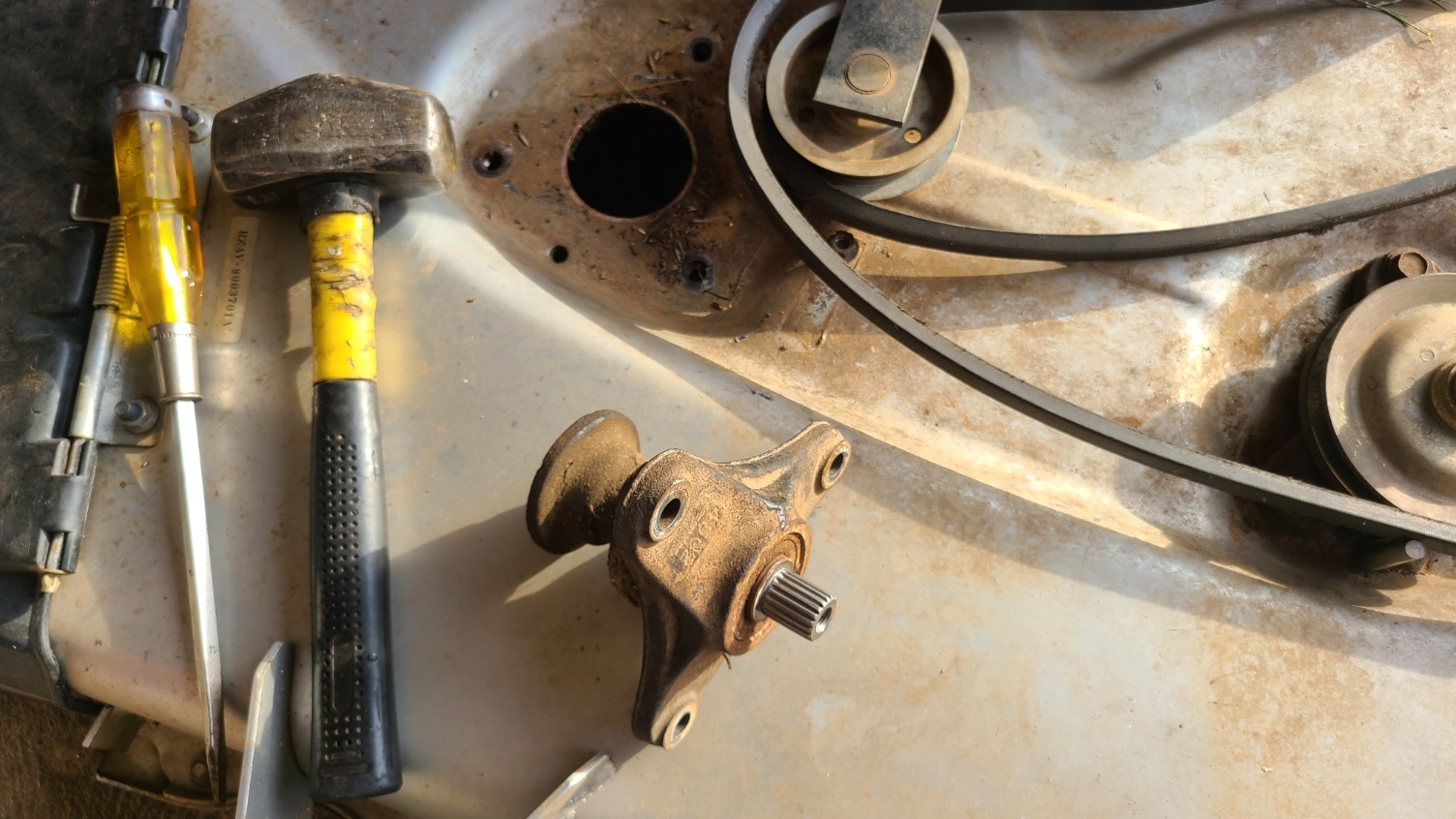

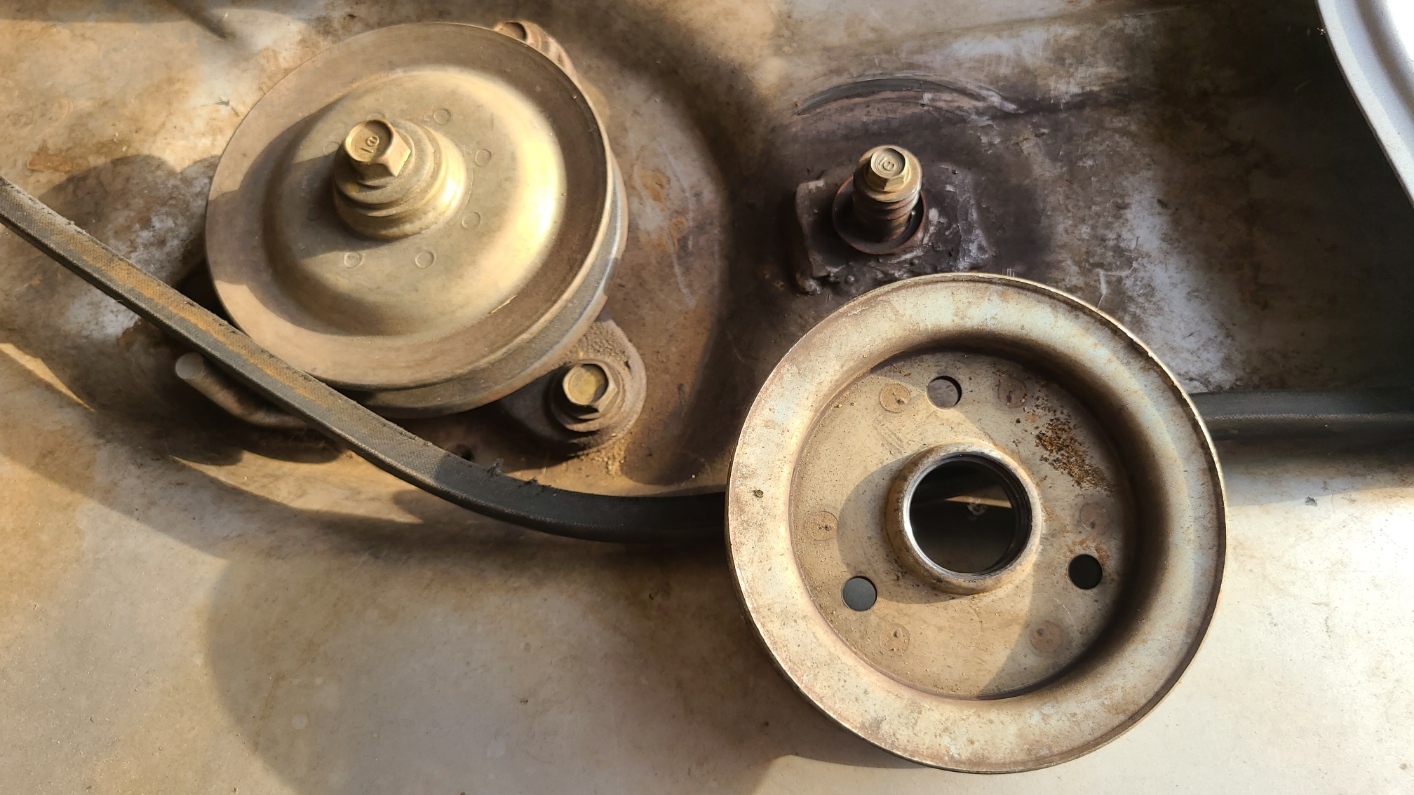

Discover the problem that one of the spendles is locked due to the bearing worn out.
Also, one of the tensioner's bearings is totally shot.
Without the deck, the engine wouldn't stop while engaging the PTO.
Time to find out the upper and lower bearing.
Thanks for commenting.
Jkk

Works good after replaced the spindle idlers bearings ..
