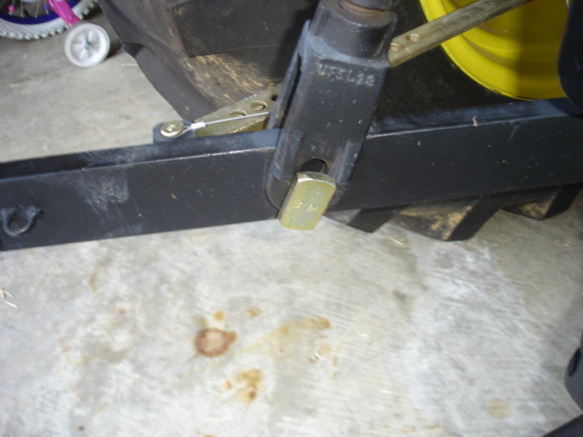

Someone advised that when using a rake with wheels, the 3ph should be in the float position. The manual for my jd2320 doesn't mention this.
I'm guessing that 'float' means there is no 3ph up/down pressure. Gravity on the rake and the wheels adjusts the rake position.

I don't know if your lift arms are the same design as mine on the 4520, but there is a pin on the arm that you can position to alternate between rigid and float positions. Here's mine in the float position, which can be rotated horizontal making the lift arms rigid. Like I said, you setup may be different.

And even if your arms have the float setting like Tacts (and mine) it won't be enough...

But .... my landscape rake with gauge wheels wants to be free to tilt small amounts as well as rise and fall. So my on my 3320 where the lift arms attach to the lower links there is a bolt, a slot and a bracket on each side. With the brackets one way, the lower links are locked to the lift arms. With the bracket the other way, the lift arms can flop up and down independently somewhat allowing for tilt of the implement. The 3320 refers to this as the "float position" of the draft links as opposed to the "fixed position".
I don't know if the 2320 has the same option.

The picture posted by Tact is what you want & should also be shown in your owner's manual or something close to it.
As you continue to lower the rake after its wheels touch down you will see the hitch lower a little more without the rake lowering further. The rake is then free to float a little.

The 2320 has position control, so there is no neutral - but the operation is the same nonetheless. Put the control to the lowest point you want the rake to go, and the ground will raise it up (float it) as terrain dictates. Now, I believe the 2000 series tractors are the same in that there is no link 'lock' like Tact posted. I think those are on the bigger tractors only. Could be wrong...
